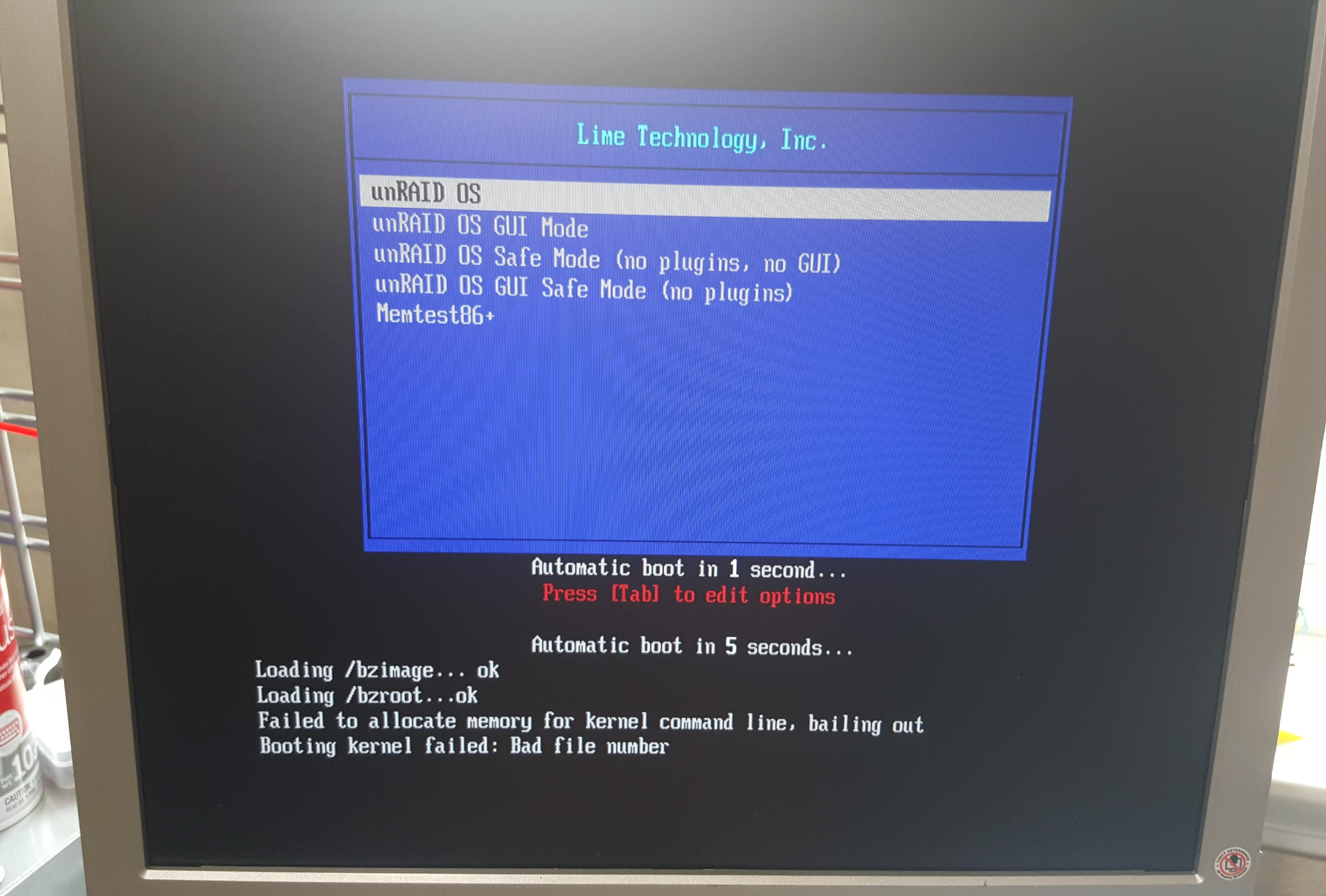

If I boot using UEFI mode, I can also get to the unRAID boot menu. Upon booting I get "Failed to allocate memory for kernel command line, bailing out. Booting kernel failed: Bad file number". Any other boot option yields the same error.

Booting from UEFI mode:

Yes I tried 6.5.2 both normal and efi and I still get the same error. Turns out whatever I used to upgrade the BIOS earlier didn't catch the latest version so when I went back to check for it, there was a new one! I got my hopes up too soon though, because after a successful flash it still wouldn't boot off of the flash drive.
There is one thing that might be causing it but I highly doubt it. It's missing its internal network card which halts the system during POST waiting for an F1 key strike to continue the boot process. I might be wrong but I don't think a network card would be causing memory allocation errors :/
FINALLY! It works.
It still shows a black screen when I boot using Legacy mode, but after putting in a network card that I had on hand I saw it grab an address and I am able to access the web ui.
