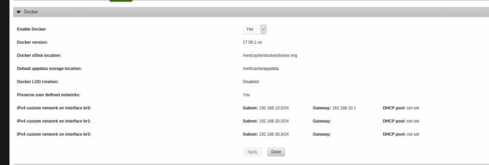

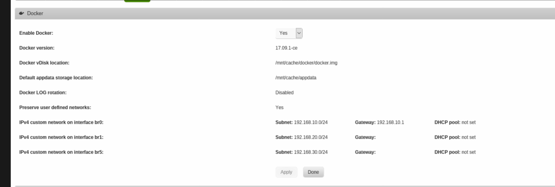

So looked at my network settings and they looked ok. Took a look at my docker settings and notice that for the vlan20 (br1) there's not gateway listed in docker. So i am ASSuming that't the reason it will not ping or connect.
Is that a correct statement? if so how can it be fixed.

The better approach is to set NO addresses to interfaces br1 and br5 (stop docker+vm service and go to network settings page)
This gives the ability to set your own subnet and gateway for those interfaces under docker settings.
