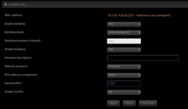

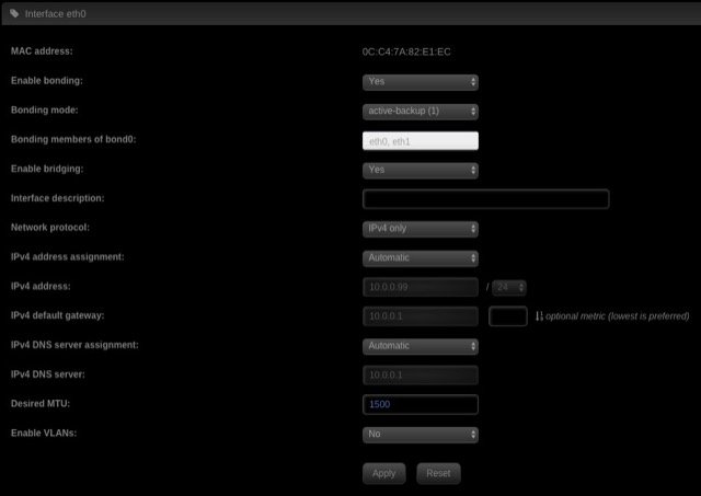

cant seem to understand what I am doing wrong.  but its not working.
the eth0 is already a bridge
but when I connect to second port I dont get IP from the DHCP
2018-09-09_09-31-29-resized.jpeg.e3629de7fb7c222f016773a38de3fcb8.jpeg2018-09-09_09-31-45-resized.jpeg.d99fd4300babb72a86692d2c6dd79c87.jpeg
For eth0:
- Enable bonding = No
- Enable bridging = Yes
- Bridge members = eth0, eth1
For eth1 (will get automatically added to the eth0 bridge)
- Enable bridging = No
