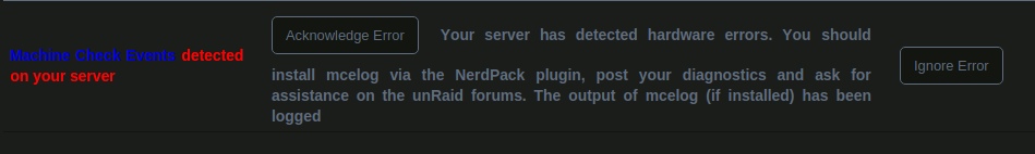

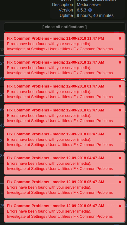

I am receiving tons of notifications about Machine Check Event errors having occurred and needing to be investigated / fixed. When I visit the Fix Common Problems plugin as the notification suggests I have:
Machine Check Events detected on your server    Your server has detected hardware errors. You should install mcelog via the NerdPack plugin, post your diagnostics and ask for assistance on the unRaid forums. The output of mcelog (if installed) has been logged.

Attached screenshots of all the above in case a setting or something could be the issue.
