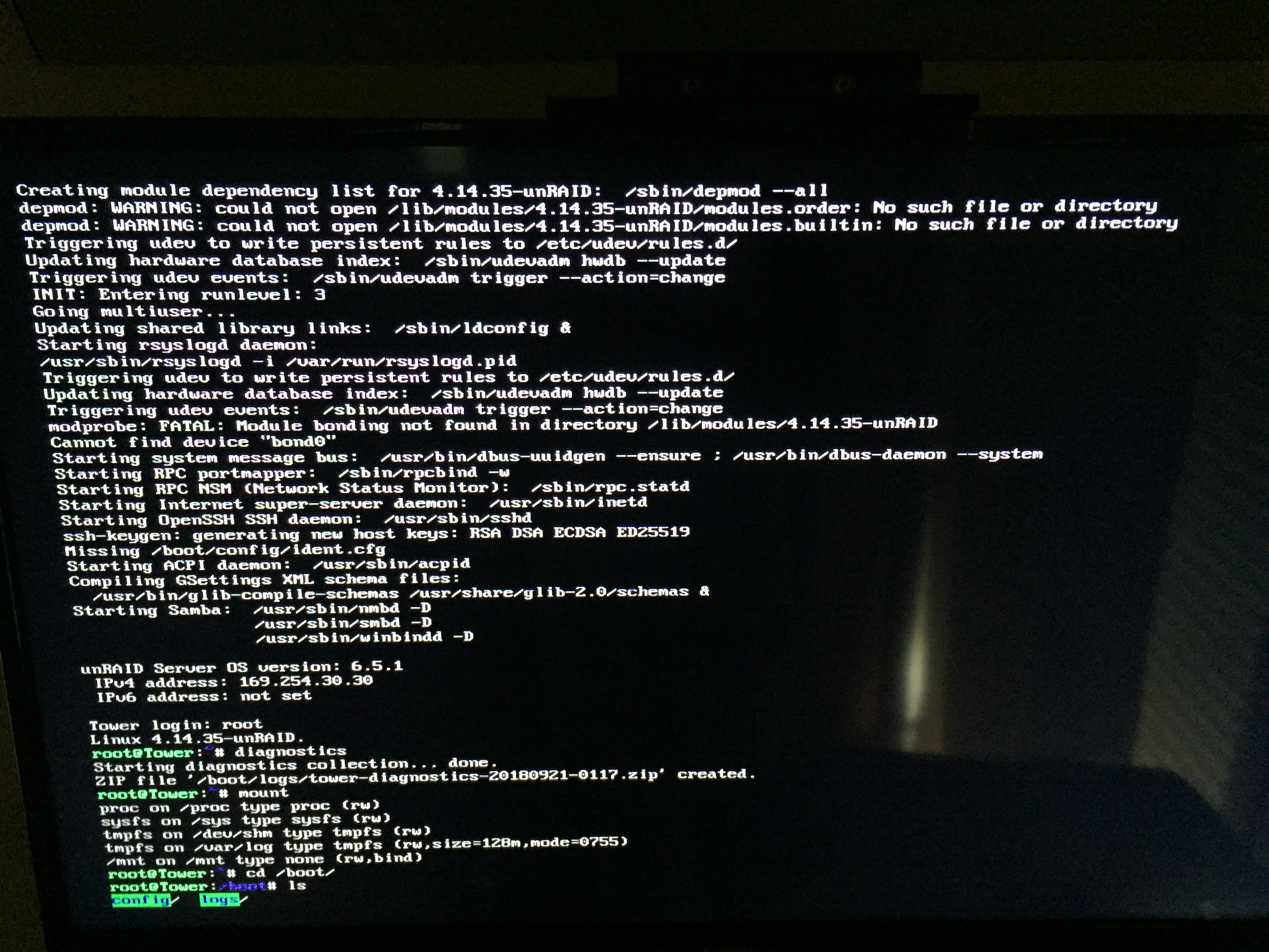

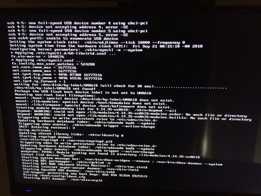

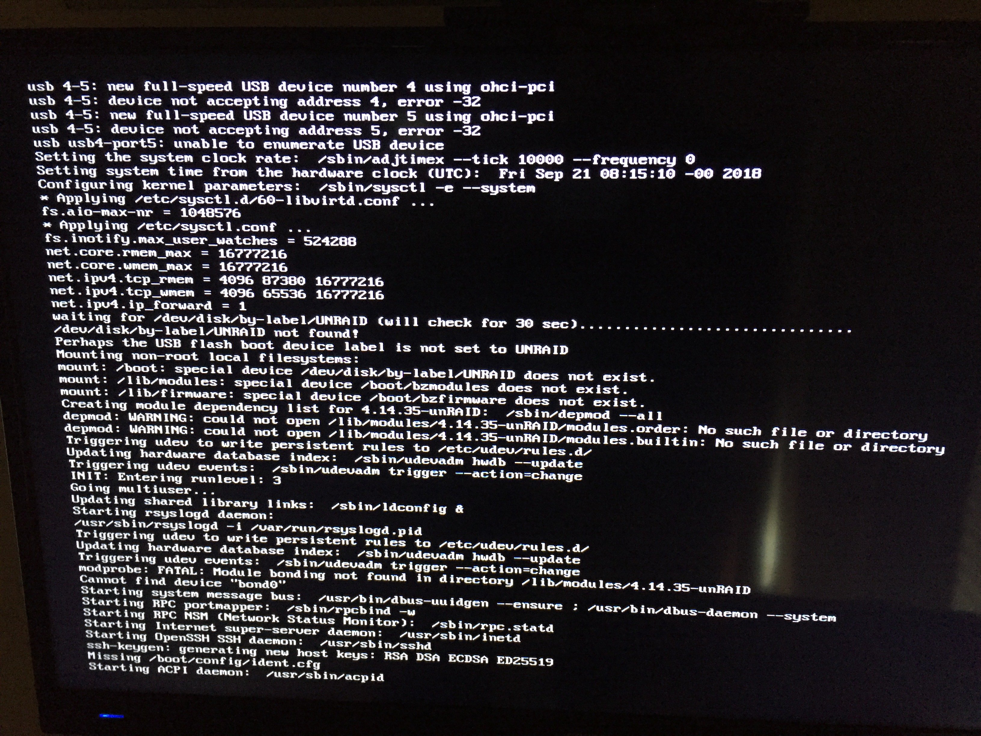

Then I simply rolled back my hardware upgrade and installed again my previous motherboard. And the hell started. I can't make UNRAID to boot from the Sandisk USB drive anymore. It always ends up with a few "device descriptor read/64, error -32" messages, to end up not finding the drive with a "UNRAID does not exist", and due to not being able to mount the volume, it isn't capable of loading network modules and such.

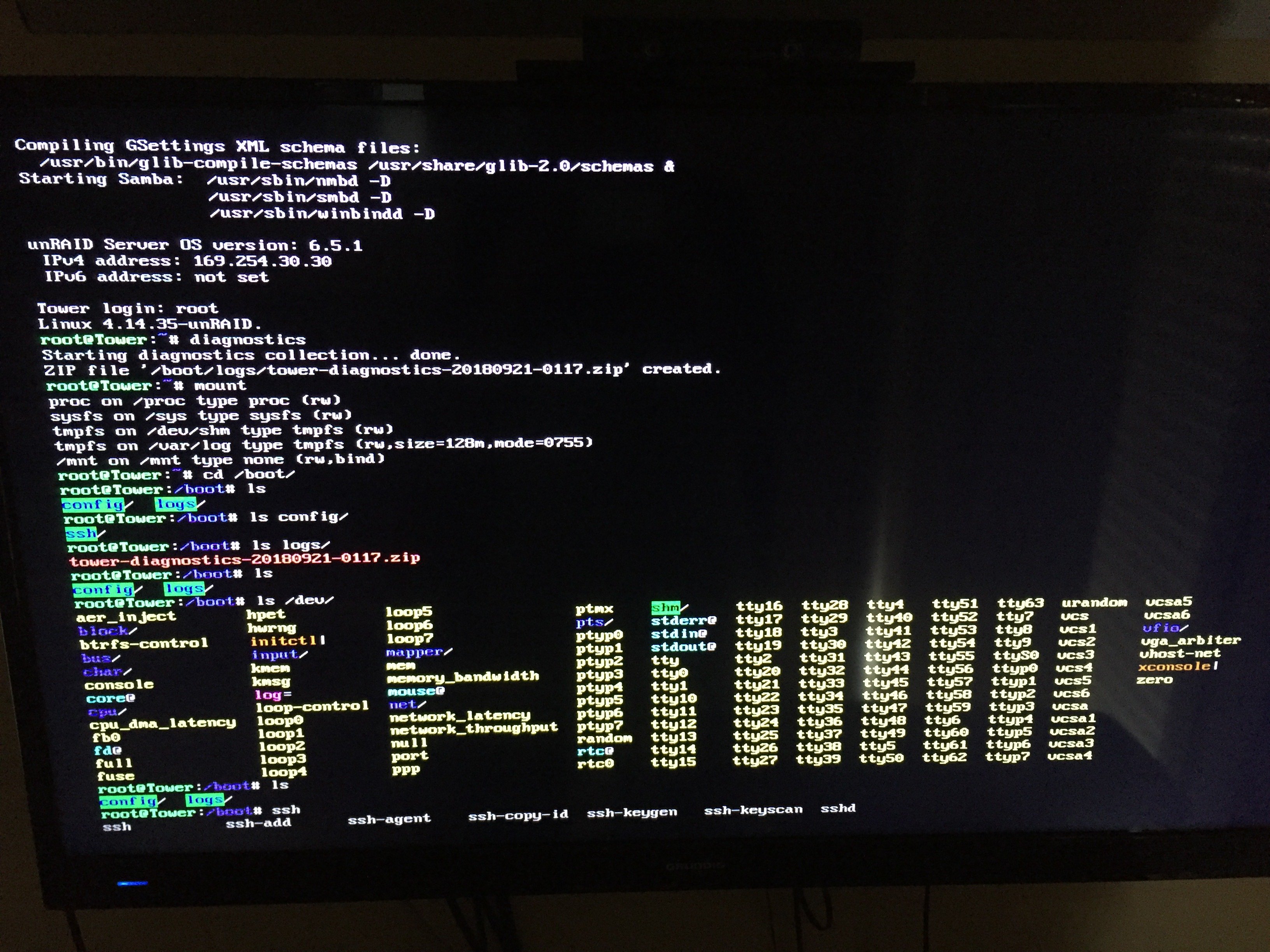

I've tried everything. I tried to unplug all drives and unnecessary cards and the only other USB device I have (the UPS). I've tried to plug in the USB device on every single USB port at the motherboard (and even the external ones). I've tried to reconfigure the BIOS to force usage of UEFI and renaming the "EFI-" folder at the drive to "EFI" (I was using legacy before, because my first Unraid version was older from this EFI support if I remember well). I've checked that the drive has "UNRAID" as label. I've passed fsck and diskutil checks / repairs to the drive from my Mac (no corruption, no repairing needed). I've even used a different USB drive with a brand new setup of UNRAID using the USB creator. Nothing of this has helped. A USB portable keyboard/mouse didn't work after boot (it works fine at the EFI bios), so I ended up plugging a PS2 keyboard to operate a bit at the command line. I can see there are no disks listed at /dev.
I don't know what else to do. But I'm a bit desperate, because it looks like I can't revert to the previous setup and get access to my files. Is there anything else do you think I might have missed?
PD: I've run diagnostics, but since the file is created at what seems to be a ram virtual drive, and I have no network or anything, I wasn't able to copy it anywhere else.
I just tried something else to discard issues with the UNRAID system that I can't explain: I prepared the secondary USB drive with a copy of a bootable Ubuntu system. And guess what... I got the same "device descriptor read/64, error -32" messages! So it sounds like somehow the chipset in charge of managing the USB devices on this board stopped working somehow with the transplant.
