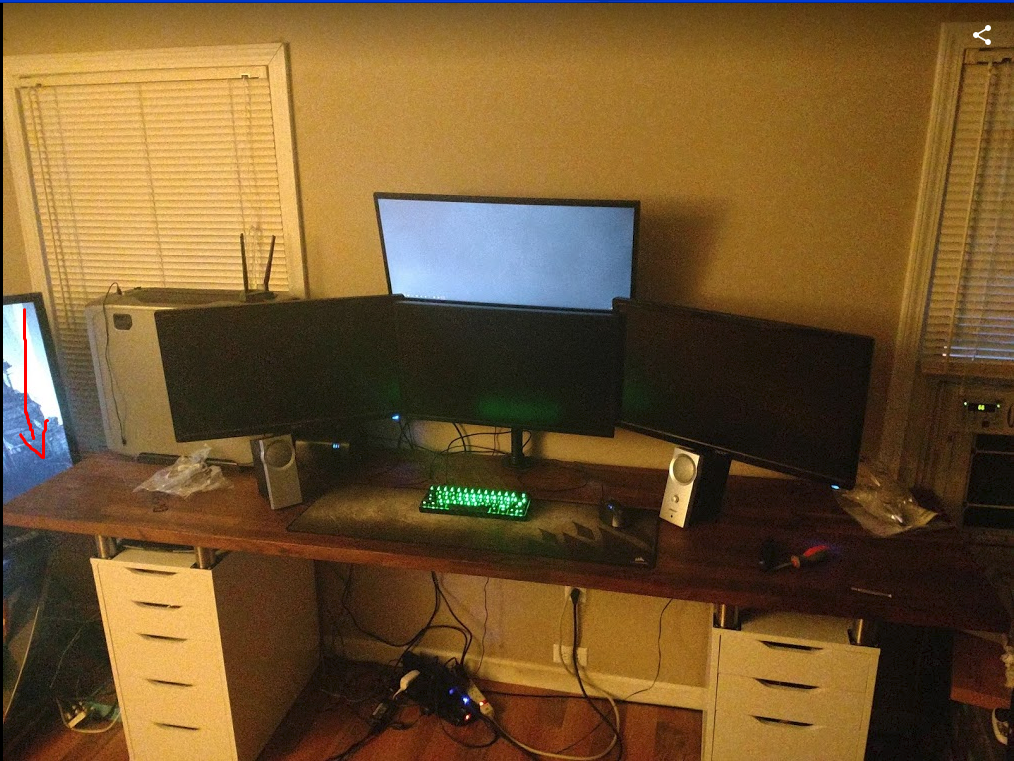

6 Drive bays should be enough honestly. I live in the south basements are not a thing down here. The location that I am gonna be putting it will be in the living room next to my main computer now. Which was one of the reasons to have it in a case. I might have to install new fans in that case that I am looking at for some quite ones but might not have to because there is a huge window unit in the living room that is on all of the time. Heat is also not much of an issue because I normally keep the house a lovely 66 degree.
Looking at putting it on the ground to the left of that white cabinet between that TV stand. (which the TV stand is not there anymore.
Then the tower should fit there just fine. Seems like that would be the one to go with then.

Sadly the house that I live in right now can't accommodate for a server rack. This server I am looking at building will be placed in the living room. So being it a pc case would be best. I also posted a picture a few comments up where it will have to go. Unless there is a way to transplant 1U server into a pc case.
