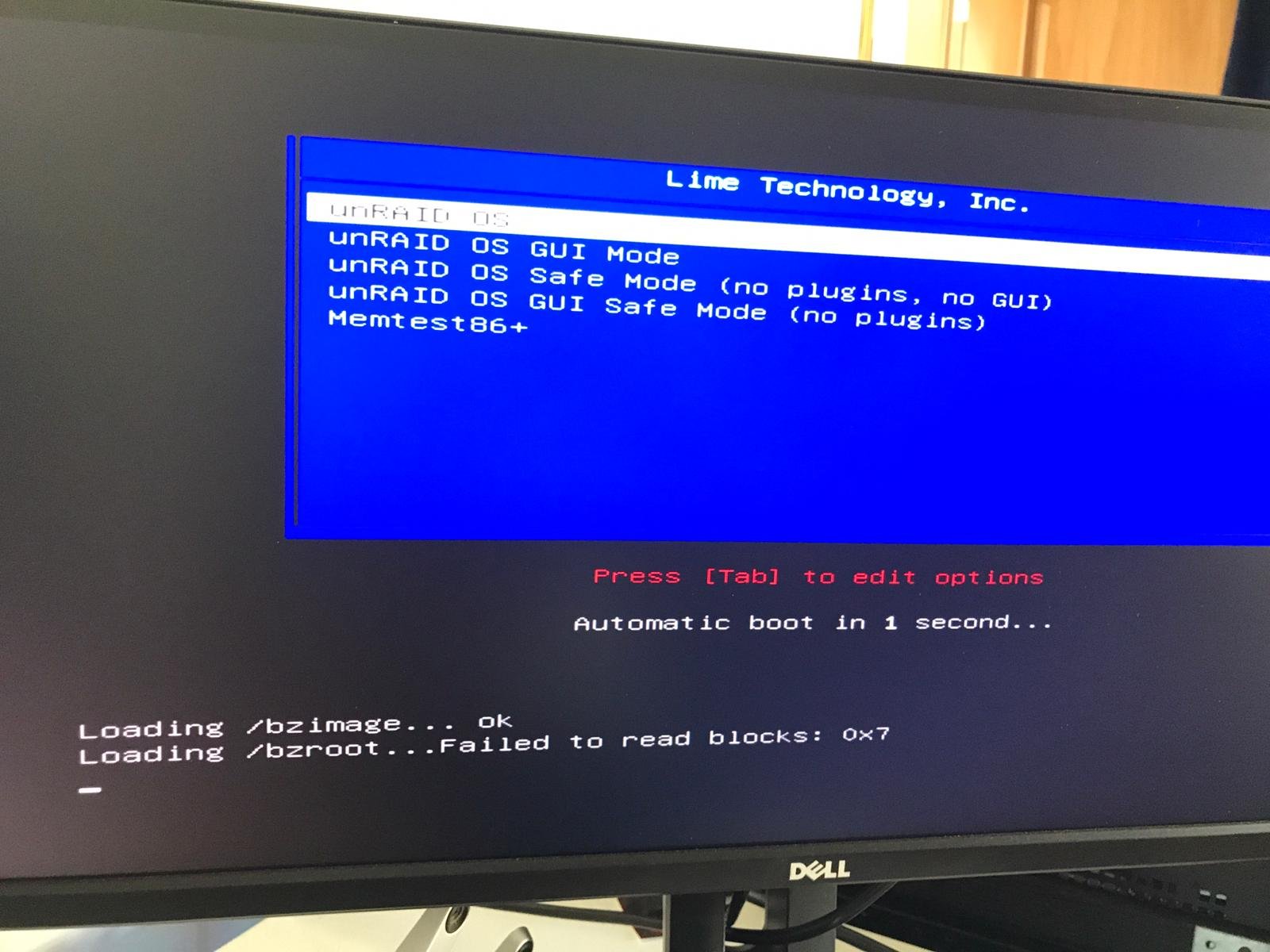

 i've done this latest updated and on one of the servers it booted with this message "unraid USB drive is not read-write"... new reboot on it and i dont see it online (i'm currently @work so remote access only)..
 Any idea on how to fix this or what caused it?

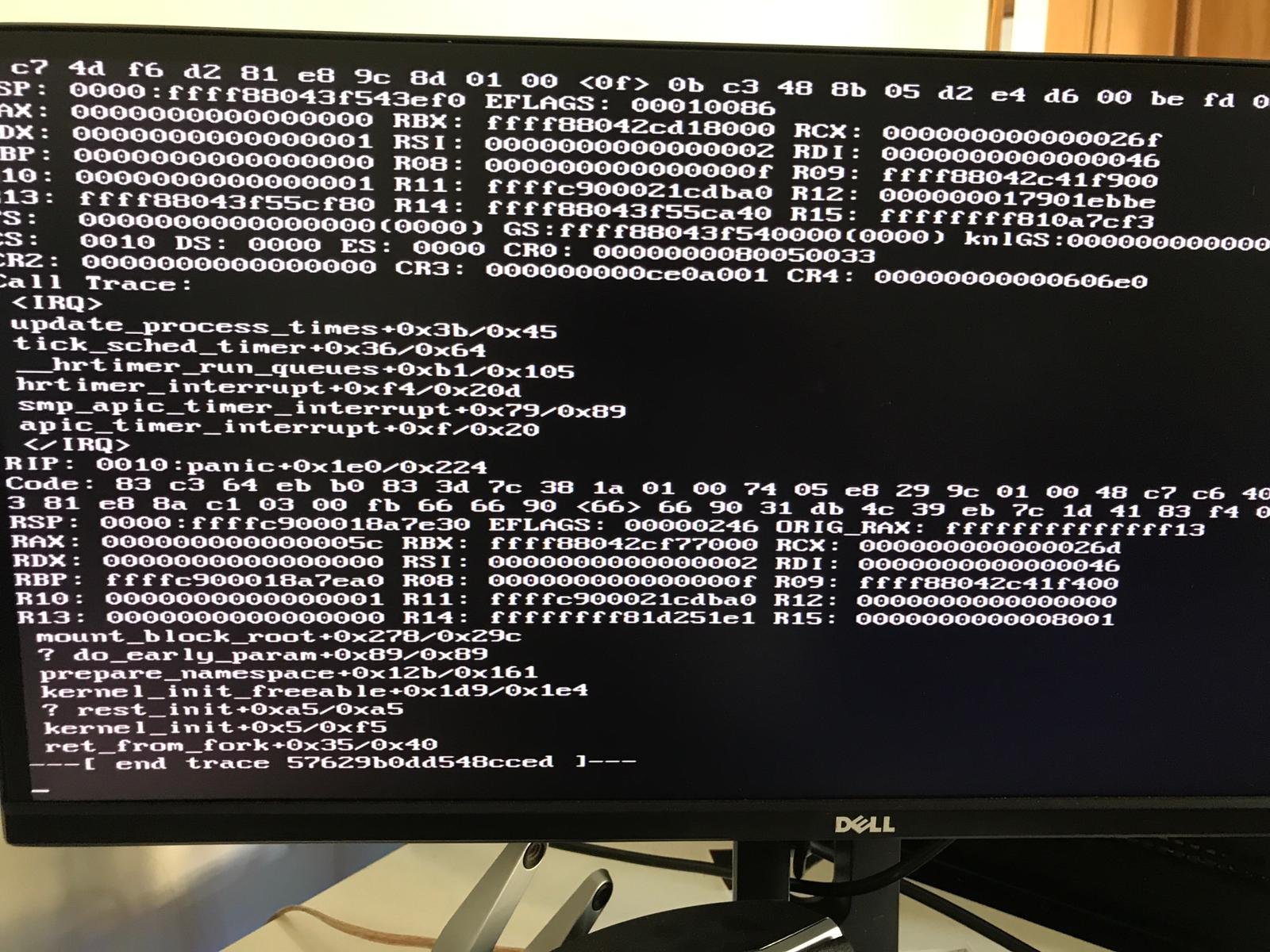

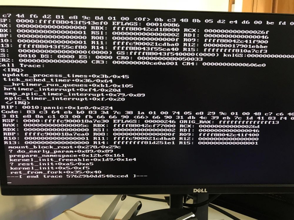

 done that, fixed erros but upon rebooting on server got a call trace and no go...
seems it is getting even worse...
Fixing the 'errors' does not always return everything to a usable condition.  It usually makes the disk readable and writable but some of the files may be still un-usable or truncated. If you have a backup of the USB, you could restore it.  You could also try to boot the disk in a different computer and see if that boots there.  (Unraid won't do anything to the disks on that system as it won't recognize the serial numbers.)
