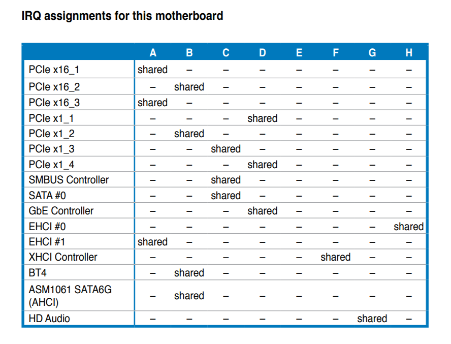

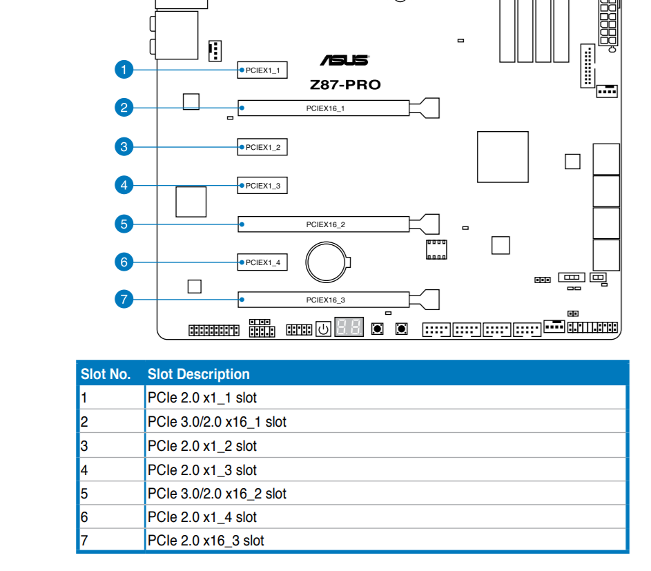

I currently have one of these controller cards plugged into slot 2 (which all 4 ports are working), and the other is plugged into slot 6 (of image 003.png that is attached to this thread). It's this one that is plugged into slot 6 that can only handle 2 hard drives at a time. If I try to plug in 3 or 4 then unRAID just doesn't detect them.
If I move that controller card to another slot on the board, would that allow me to add two more drives to the pool? Or is there something else that is limiting these two cards to only being able to use 6 drives? If so, could replacing these two controller cards with that 8 port card resolve the issue?
