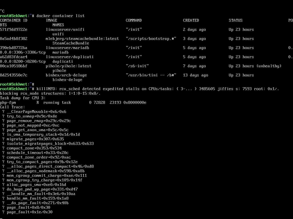

I am unable to access the server via any method except my ipmi console (SSH not responding, samba/nfs not responding, web ui not responding).
I'm unable to stop or force-quit the php-fpm process, or kill it with kill -9, or killall php-fpm. Using the stop or force-quit just sits until it fails.
When I list my docker containers with a docker container ls, I see that one my pihole/pihole:latest container has a status of unhealthy. I am unable to stop or kill any of my docker containers, the console just sits there. I've tried stopping / killing the ones even in a healthy status with no luck.
I am unable to force-quit, stop or kill -9 the docker service just like the php-fpm.
When trying to stop a ontainer, or php-fpm I occasionally see the following message about killinfo: rcu-sched detected expedited stalls. I am posting a screen capture of the error as I am not able to connect to get it in a text format, nor can I push data out of the server via the network. The CPU is currently operating at 42C from the supermicro ipmi console temperature reading.

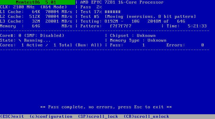

I've rebooted the server after grabbing those and running memtest as suggested as well.

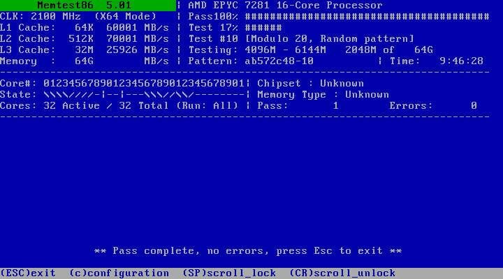

Well it passed the first pass of the memtest.
Well I ran the memtest with no issues / errors through this morning. I'm going to bring the server backonline into unraid now and see how long until it happens again.

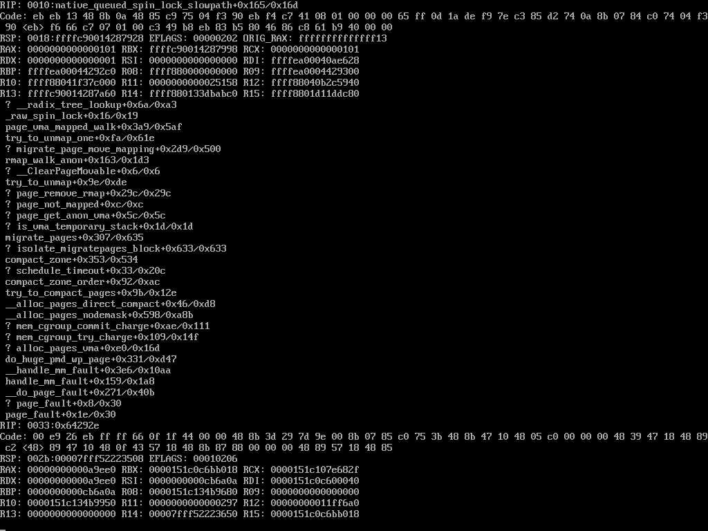

I did notice something the following that happened right before the rcu-sched errors started this time while reviewing the syslogs, but I'm having trouble determining what program may have caused it.
BUG: unable to handle kernel NULL pointer dereference at 00000000000000300
Oct 11 14:22:28 Sekhmet kernel: BUG: unable to handle kernel NULL pointer dereference at 0000000000000030

Another hang up today.
This time I was able to access the web page (though anything related to docker, plugins or the app page wasn't loading) & via ssh so I was able to get diagnostics this time.
Was unable to stop dockers via command stop or kill commands. Tried a shutdown via the web page and it hung, tried a powerdown command via the console following and stuck again at ccp 0000:06:00.2: disabled.
