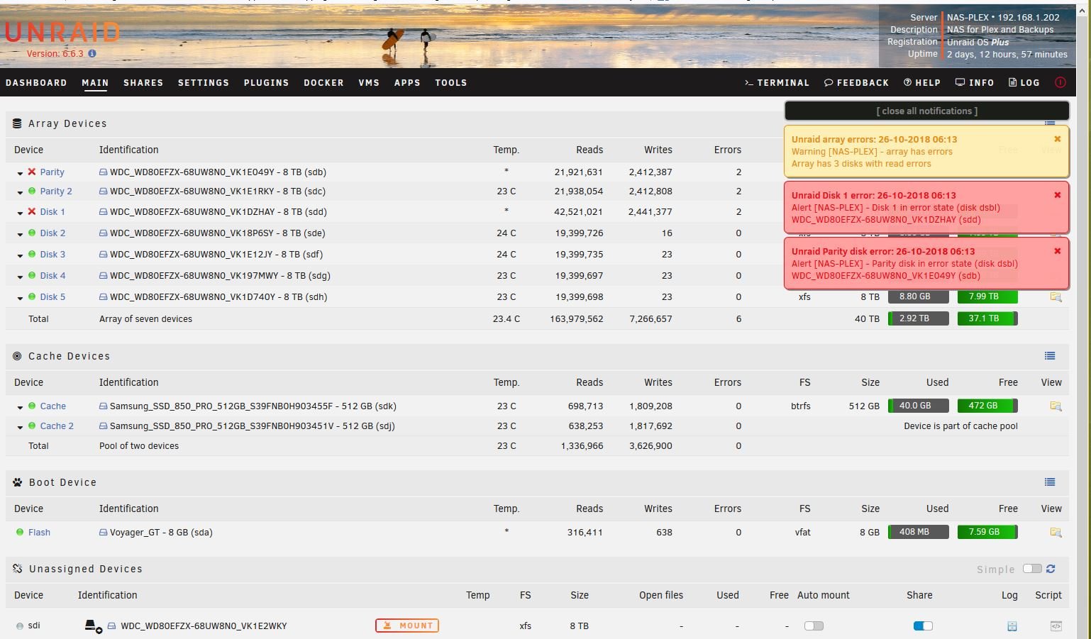

Hello folks - I was transferring three movie files from my desktop PC to my array when the transfer failed on the last file. I checked the unRAID Main page and saw that there were some errors displayed by the Notification tool. See picture below.
I then tried to capture Diagnostics as requested but the process hung. I left it for 20 minutes but nothing was generated. I then looked at the Dashboard and saw the CPU pegged at 100% on all 4 cores.

Likely a problem with the miniSAS cables connected to those disks, check/replace cable and if the emulated disk1 is mounting correctly you can rebuild it and re-sync parity at the same time to get the array back to healthy.
