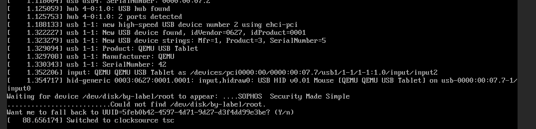

I'm using the aforementioned Linux VM settings. BUT during boot it hangs at "could not find /dev/disk/by-label/root", please see screenshot.
The disk type is SATA which points to my .img file.
Can someone help me get past this?
