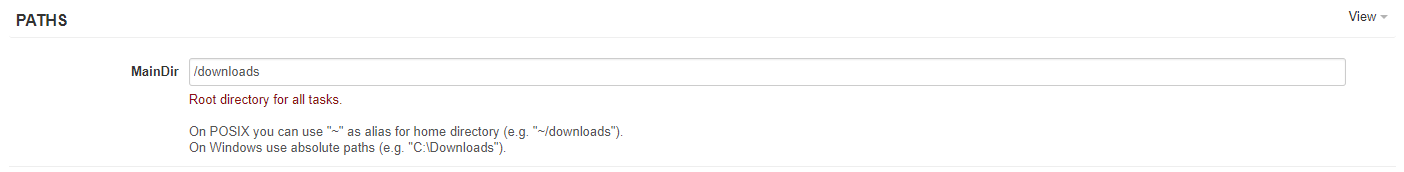

I follow what you are saying and the symptoms point to that. I thought I had the path correct. I have posted the paths below.93a5d01c99aa9542900873fab77b1543.jpg3df0d8d8f45139bf45875a92260b6f4c.jpg2e0a2162266f051b2f980f020fcff48f.jpg7b96ba5570112e3695df2d525582cecb.jpge91cc34919b0c47fe252530b724dd94f.jpg

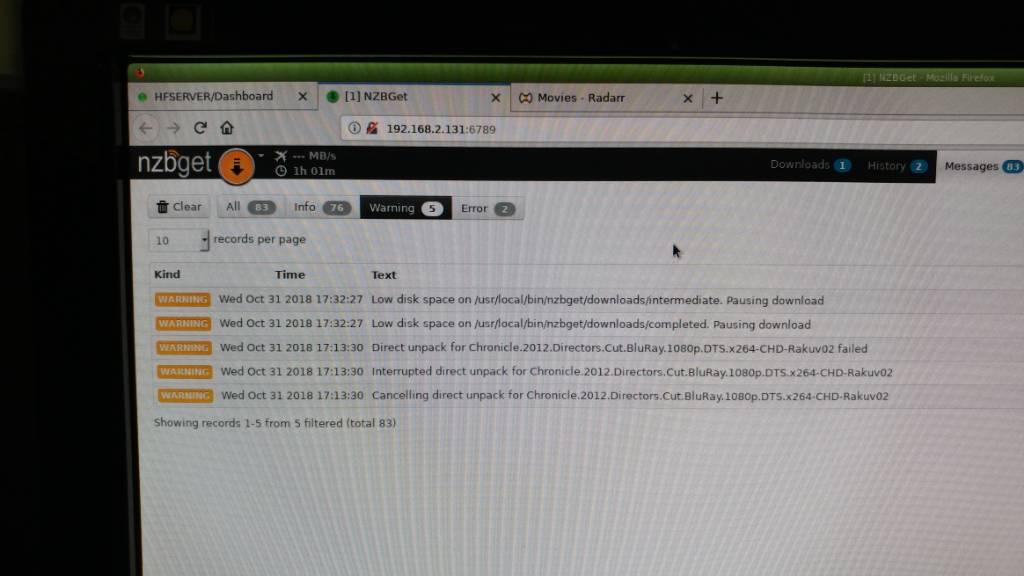

Your MainDir needs to be /data instead of ${AppDir}/downloads
Mine is setup to have a container path of /downloads so I set mine up accordingly.

That was it changed the main directory to
/data and corrected the issue. Thanks to both of you for helping me out with this and providing me with great info to read up on.
