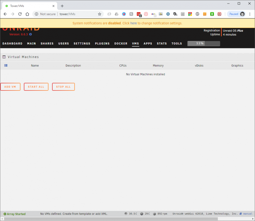

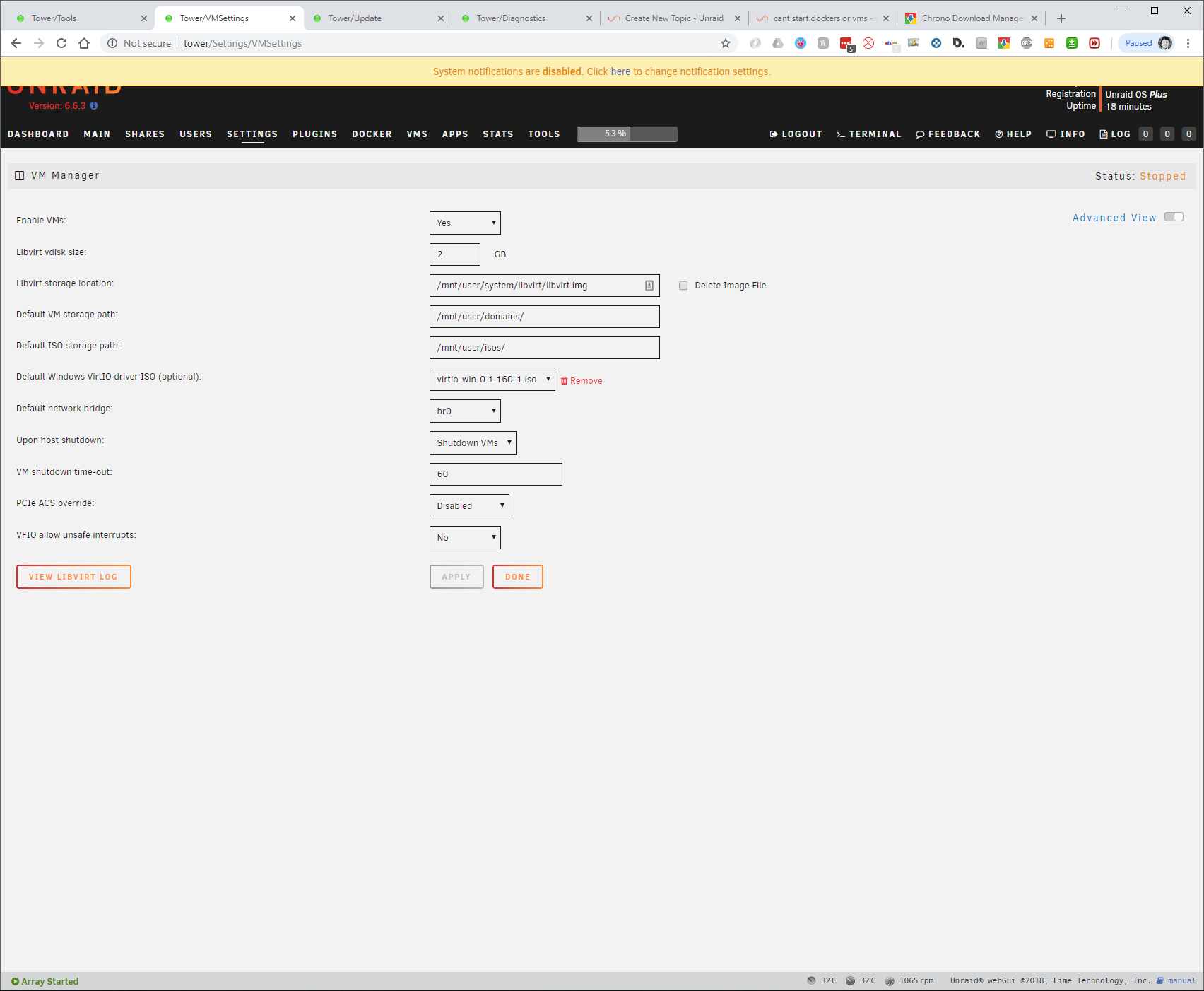

Recently had an unclean shutdown - just tapped off the power switch by accident.  After rebooting the two vm's I have set up (windows and linux) were missing.   When I stopped and started the VM service it failed to start, giving the error "Libvirt Service failed to start."  I am pointing to the proper ISOs folder, domains folder, and libvert image directly. I am running 6.6.3 but was running 6.6.1 when it happened.
I have tried rebooting the box.  On fresh boot it will show th VM's tab with no images.  On restarting the VM service I will receive the error noted above.

libvirt.img appears to have started fine the first time, then it was stopped and didn't start anymore because of this:
Nov  2 16:49:20 Tower root: /mnt/user/system/libvirt/libvirt.img is in-use, cannot mount
Try rebooting, if it doesn't start after boot grab and post new diags.

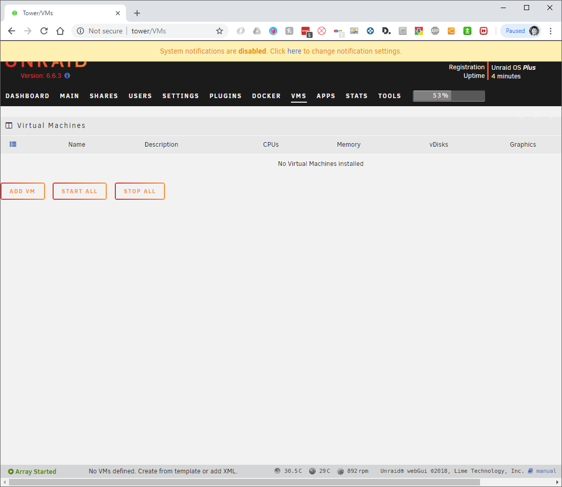

Hi, I've rebooted - same behavior.  VM TAB appears, but the two VMs I have installed are not there.  Fresh diagnostics attached.
