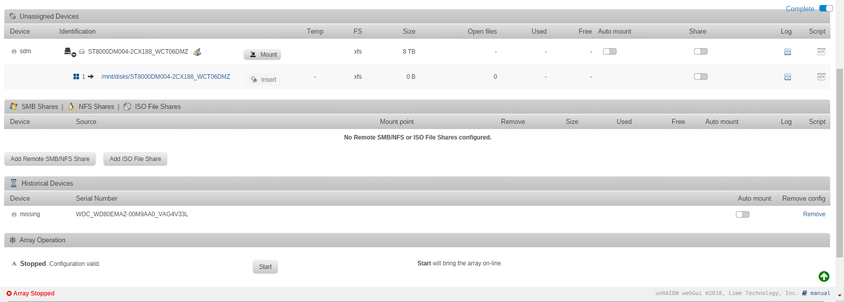

Use the UD plugin and see if it mounts correctly, if it does and assuming the disk is OK (in doubt post a SMART report), instead of rebuilding do a new config with it and resync parity.
from UD the disk doesn't want to mount, after each attempt it reverts back.
734806646_Screenshot2018-11-1620_56_49.thumb.png.67df8cf0d49eee4cc2b4fc4f2446731b.png
would there be any benefit to running the File System Check offered in blue under the drive? or could i do a xfs_repair -v /dev/sdm1?

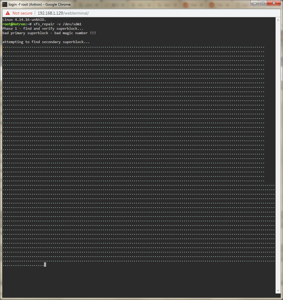

when I do xfs_repair -v /dev/sdm1 in maintenance mode it wants to run like this for a long time

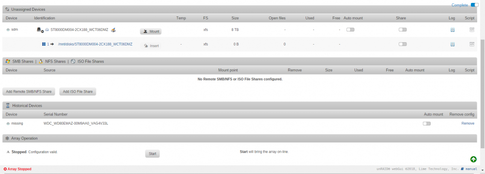

I have both the original disk5 and the replacement disk in UD, neither wants to mount. I'll attach a new diagnostic so you can see the smart values of the original disk (ST8000DM004-2CX188_WCT06DMZ-20181117-1918  (sdn))

I just noticed you've said in another thread with a similar issue:
XFS_repair is searching the disk for a backup superblock, I remember it can take a while in big disks, unless there is something wrong with the disk, like pending sectors, just let it run.
So I'll just let it run overnight and cross my fingers it doesn't end in an error.
I'll write again when i see a result

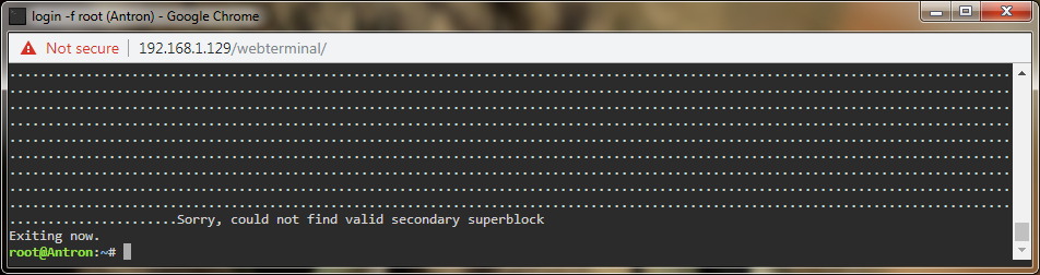

It' not good, it means the primary superblock is damaged, but let it run, it may found a backup superblock.
completed with the above message. it does not look good.
any other options or am I looking at a new config without the data on disk5? and is there a way to rescue the data on the bad disk outside of unraid and reintegrate it?
