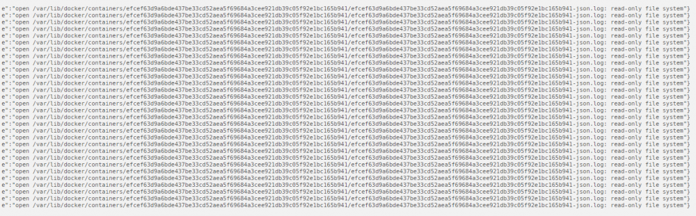

I have been trying to solve this myself for a month or two. Basically, the docker becomes read-only and shuts down all my dockers. Here is what I have looked at / tried.
Logging when it happens:
Nov 21 04:00:54 BBB CA Backup/Restore: Deleting /mnt/user/appdatabackup/[email protected]
Nov 21 04:00:57 BBB CA Backup/Restore: Backup / Restore Completed
Nov 21 04:40:01 BBB root: Fix Common Problems Version 2018.11.03
Nov 21 04:40:20 BBB root: Fix Common Problems: Error: Unable to write to Docker Image

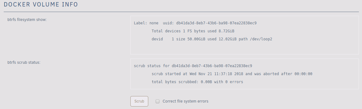

DOCKER VOLUME INFO:
132775941_2018-11-2111_41_11-BBB_DockerSettings.thumb.png.ed7aea1d318bed9a8f331febe967c817.png

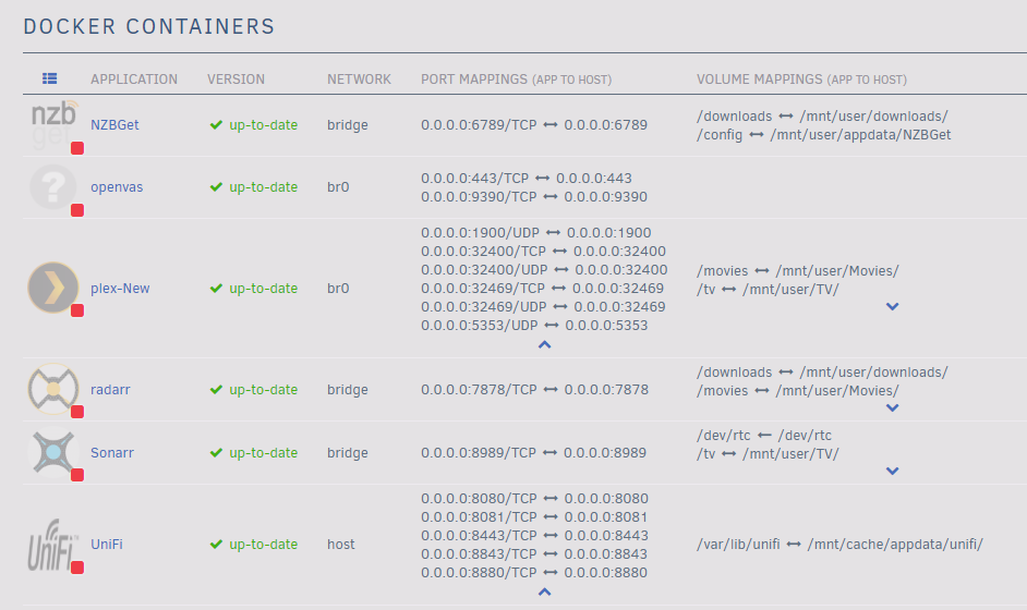

DOCKER CONTAINERS:

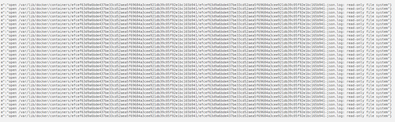

Docker Container log:
USER SHARES To Docker Mappings:
/mnt/user/downloads/
Use cache disk: NO
/mnt/user/appdata/
User Cache disk: Prefer
Use Cache disk:NO
/mnt/user/Movies/
Use Cache disk :NO
/mnt/user/TV/
Use Cache disk :NO
