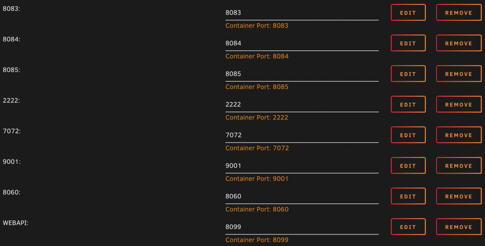

i've installed a custom Docker countainer which exposes 8 different Ports (8083, 8084, 8085, 2222, 7072, 9001, 8060, 8099). The container is in host mode.
I can reach the webinterface of the docker application on port 8083. Ther Ports 8084, 8085 and 8099 should also give access to the webinterface but i only get a "ERR_CONNECTION_REFUSED" error in my browser.

So why is the port 8083 bound to 0.0.0.0 and the 8084 Port bound to 127.0.0.1? The configuration in the Docker file (https://github.com/Gizmoh1683/fhem_unraid/blob/master/Dockerfile): ("EXPOSE 2222 7072 8083 8084 8085 9001 8099") and the docker configuration in unraid for the port that works an the other ports is the same:
What can i do to fix this?

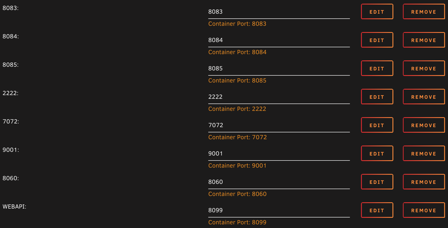

Okay, i've removed the port mappings, the port . 8083 ist still accessable but no change for the other ports.

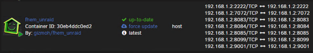

On 11/23/2018 at 2:26 PM, bonienl said:
What does it show for ports on the docker page?
