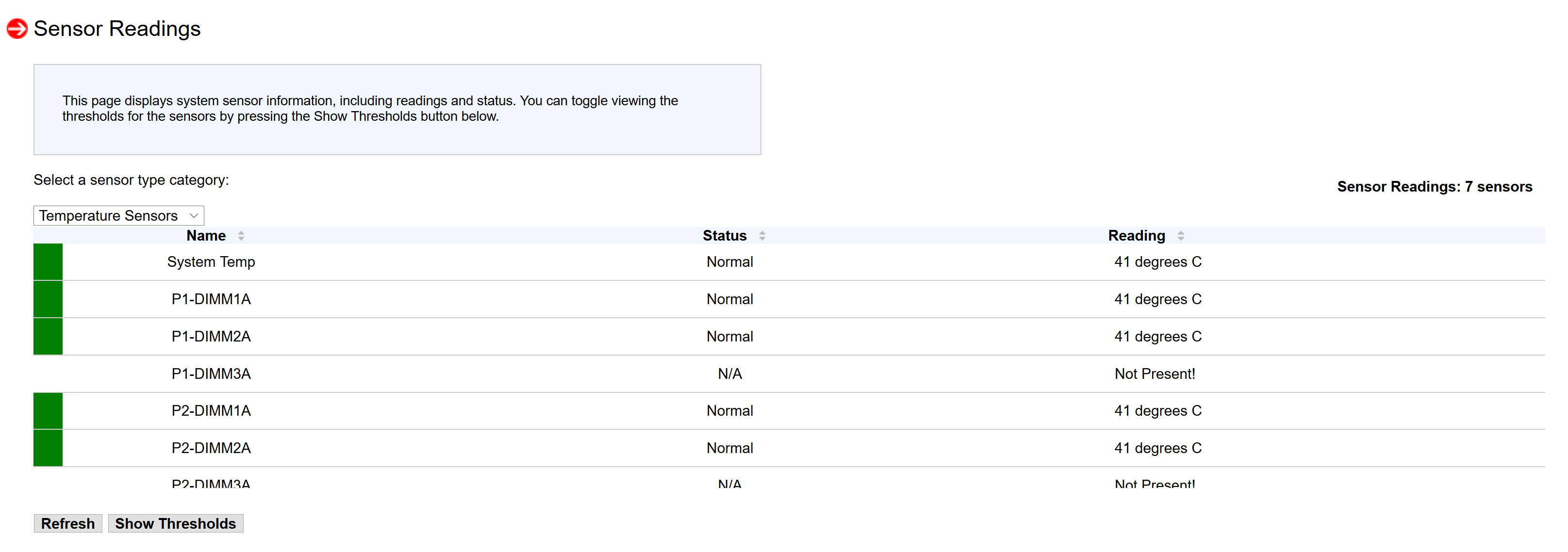

if you have a Supermicro board, does it come with IPMI? if yes, check all sensors via IPMI, i never seen a sensor named "intel5500" on my SM boards..
I can't find that temp or label in IPMI (see screenshot). This temp was in Dynamix system temperatures. I attached a fan to the chipset heatsinks and am now seeing temps in the low 60's on the intel5500 according to Dynamix. The server has been stable for about 15 hours or so even before attaching the fan.
if all IPMI sensors are fine then i have no idea, what else can you prove. and 60c is much better..
