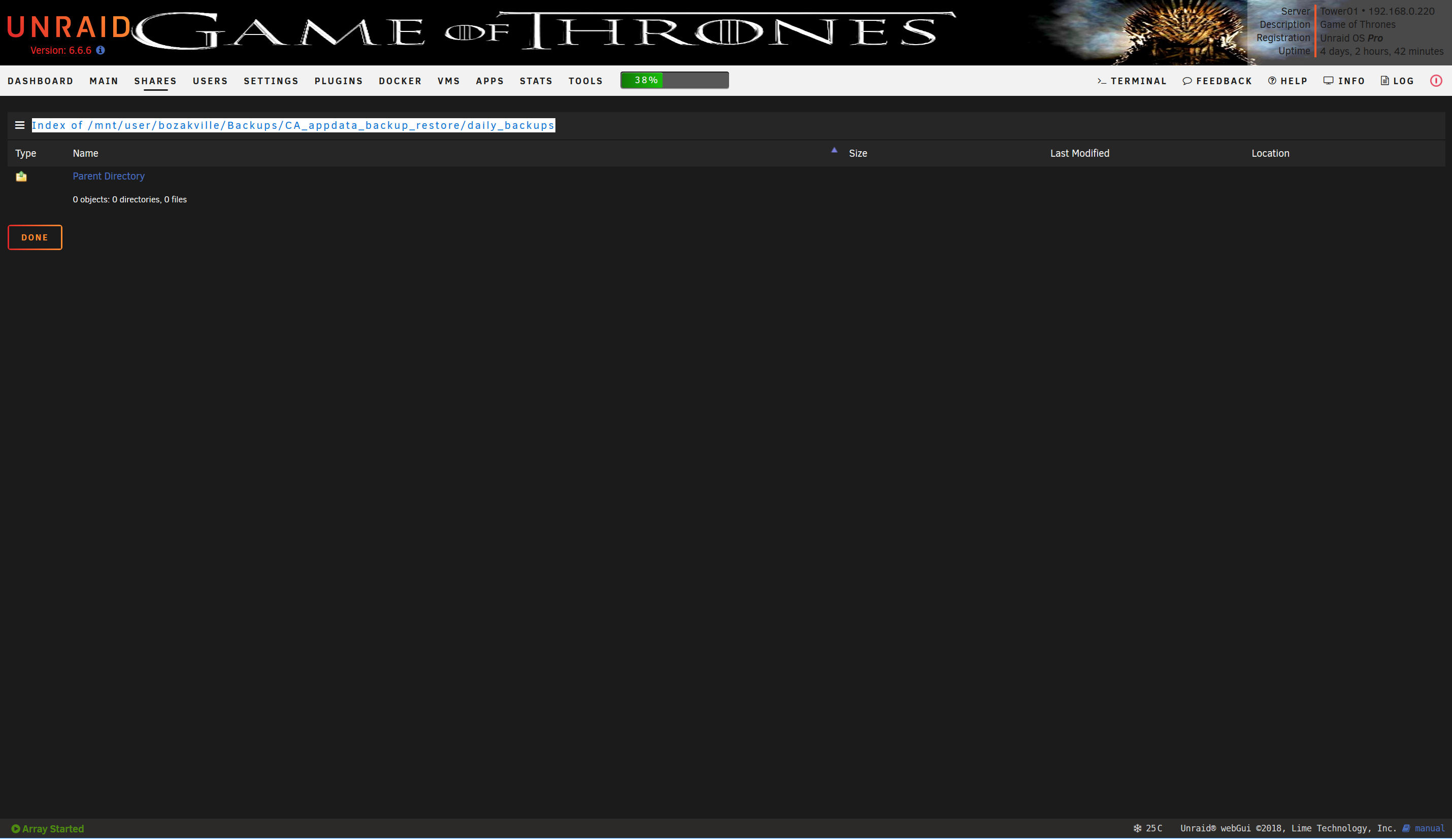

Entire path:
Index of /mnt/user/bozakville/Backups/CA_appdata_backup_restore/daily_backups
And, I would randomly check it to make sure it was working.
Nuthin but tumbleweeds...

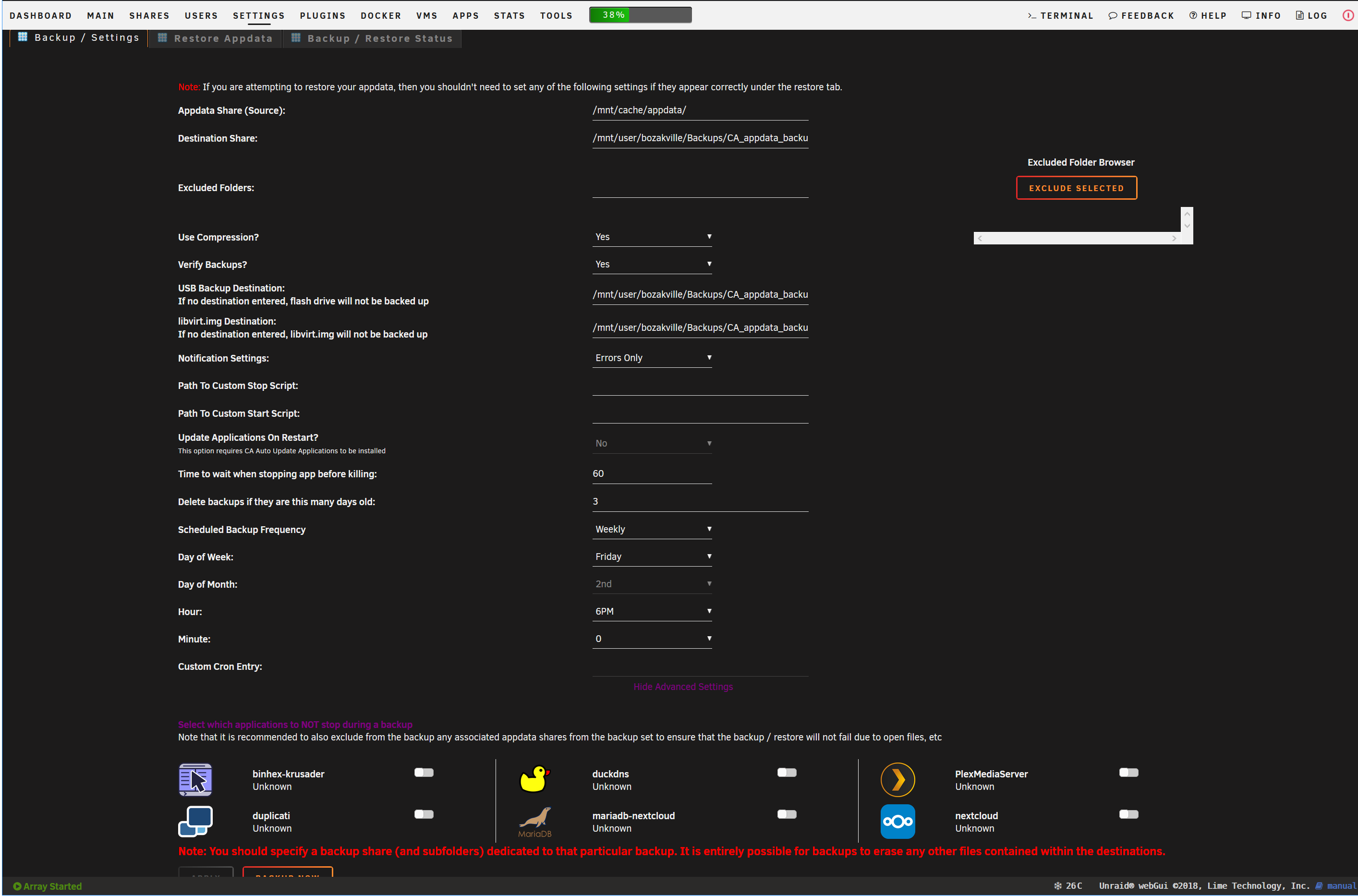

Here is a screenshot of my AppData settings too...
From the share settings
shareUseCache="yes"
Which means that the new backup set would have gone to the cache drive (which then got pooched probably before mover ran to get it onto the array), and the time to keep old backups was 3 days, but the backups ran every 7 days, which means that there was only ever a single copy made
