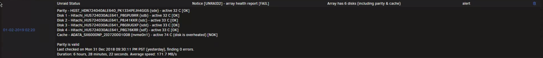

I do seem to have another issue. My array health report is showing failed. I have attached an updated Diagnostics  Zip.
Can you post that report? It typically has more details than just "failed".
Oh, how do I get that report? That maybe part of my issue.
You said there was a report. How did you know there was a report?
It is the notice I get each night with info. I am not sure how to check the array health report for more information. See attached screenshot
Go to Settings - Notification Settings and configure it to alert you by email or other agent as soon as Unraid detects a problem. You don't want to have to check for these things, you want to be alerted immediately when you get a single problem so you can deal with it and not accumulate even more problems you can't recover from.
When I click on that report this is all it shows me:
That is from the Archived Notifications page.
I do appreciate your help with this, thank you
The (NOK) line is your cache too hot. Everything else is OK.
