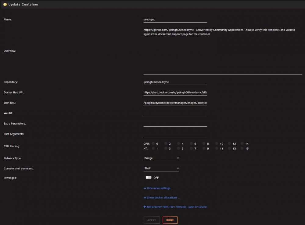

This is my container settings:
Yea it seems to not support it. I did manage to change which user it runs under but then I get an error because it is not able to execute a python startup script.
Even with root owning the files, that's not a problem so long as permissions are correct.  If you can adjust the permissions of the written files within the container's settings to be 0777 you won't have any problems.
hmm I don't know how to do that :/ I am pretty new to docker have some linux background.
Many applications have on option in their GUI to set permissions on written files.  Set it to 0777 if you can.
If that doesn't work, then you'd have to run this on a schedule or on demand
chmod 0777 -R /mnt/user/nameOfShare
I did create a cronjob that does this for me every minute. This seems like an ugly walk around though not an actual fix. When I change user it is the SCP failing not python script.

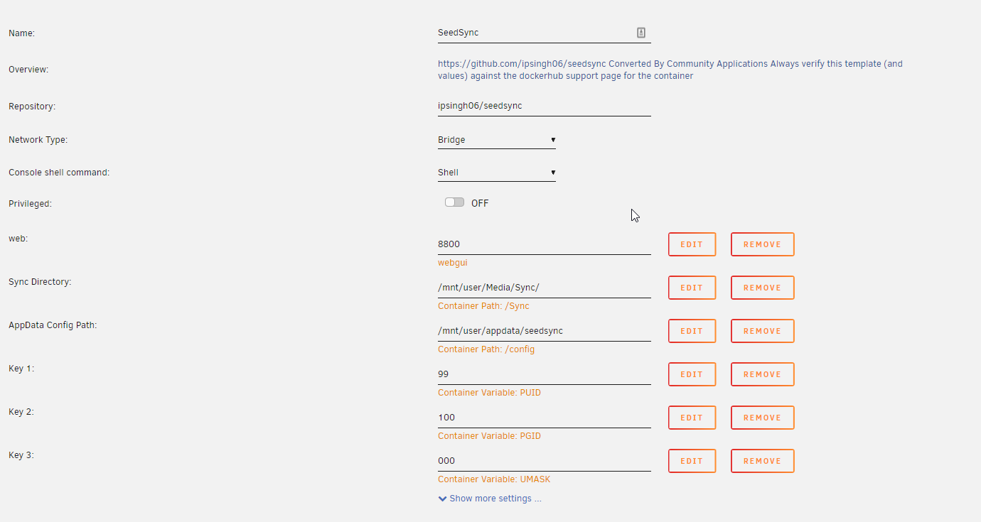

I have recently started setting up my unRAID server and was looking for a service to do just this. apparently the developer had (about 19 hours ago) updated the system to resolve the user permissions issue listed.

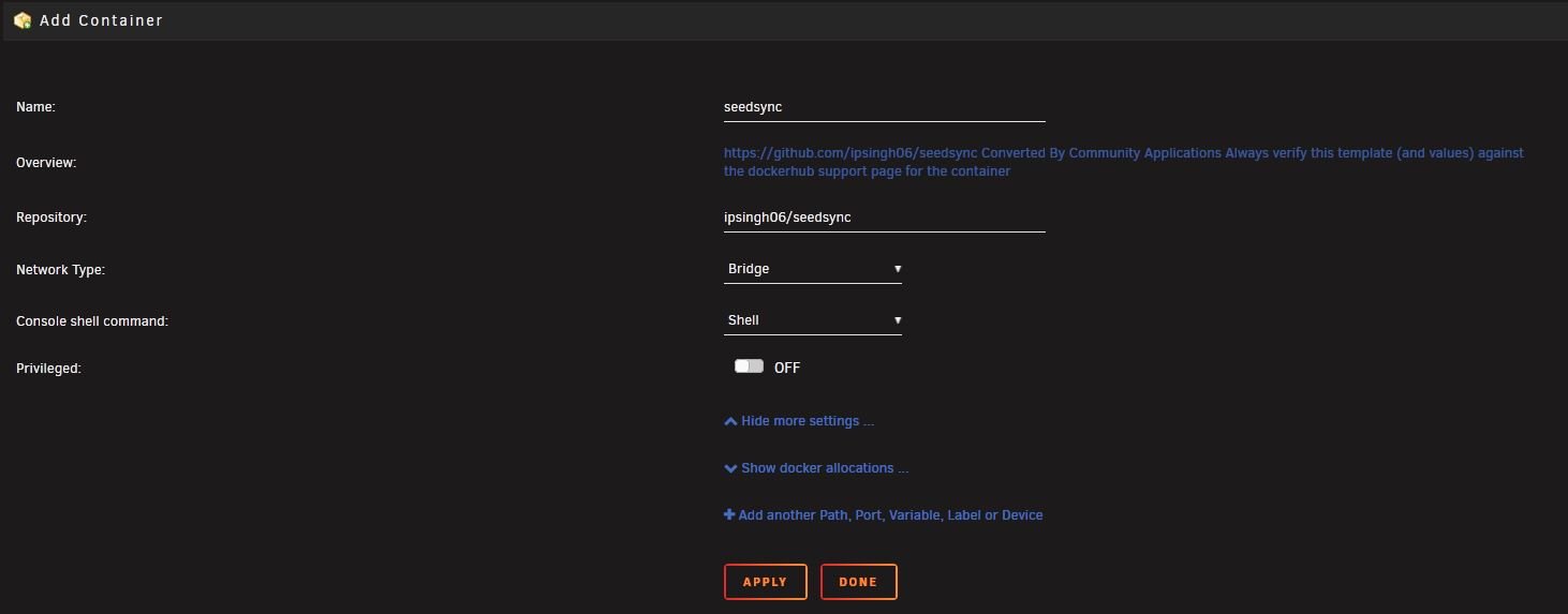

but i would love some help if i may, when i try to add this i'm not prompted with any of the web-UI or sync setting options and am quite puzzled as to what i'm doing wrong.
Move the slider at upper right to from Basic View to Advanced View
Thanks for the reply, im afraid however advanced opens up manual control of the icon and forced port but the parameters do not match the required 'config' and 'download' options unless you may know what the 'extra parameters and post args represent?
Edited by radfx
I understand that I have to give the software the parameters it wants for it to work, my issue in even the example you gave linked is that I’m not getting an option field to enter those. I’m getting (with advanced on) webui and parameters.
no fields for config path , no host path or host key fields

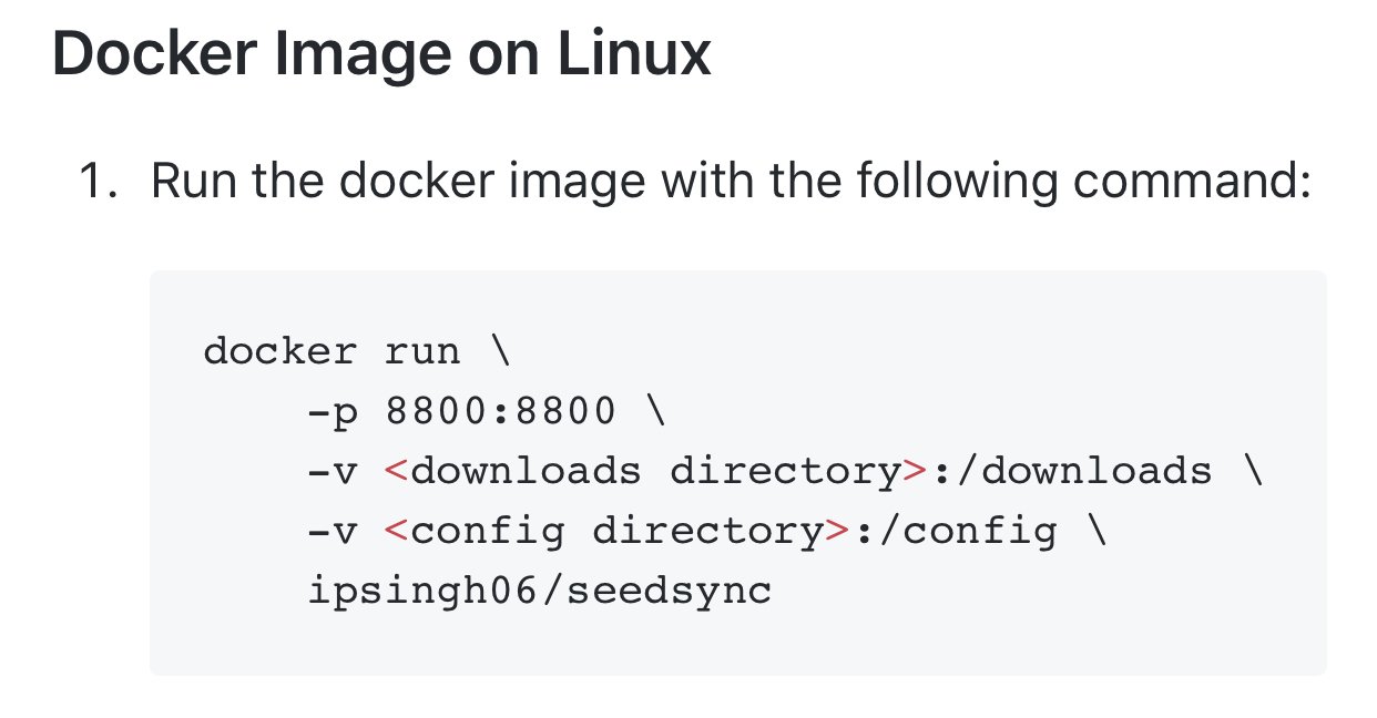

these are the instructions from the developer attached
but if you do part my screenshot to OP’s he has a lot more fields to fill out
i have tried going via terminal and typing in the command as listed (bypassing the store/docker repository completely) but I may not have had the path set correctly.
My issue is not being given the path options at setup (as seen in the images)to set in the first place
That last line of blue text at the bottom of your screenshot. Click on it.
And from there I can force ‘config’ and ‘downloads’ path?
will try,
cheers.
