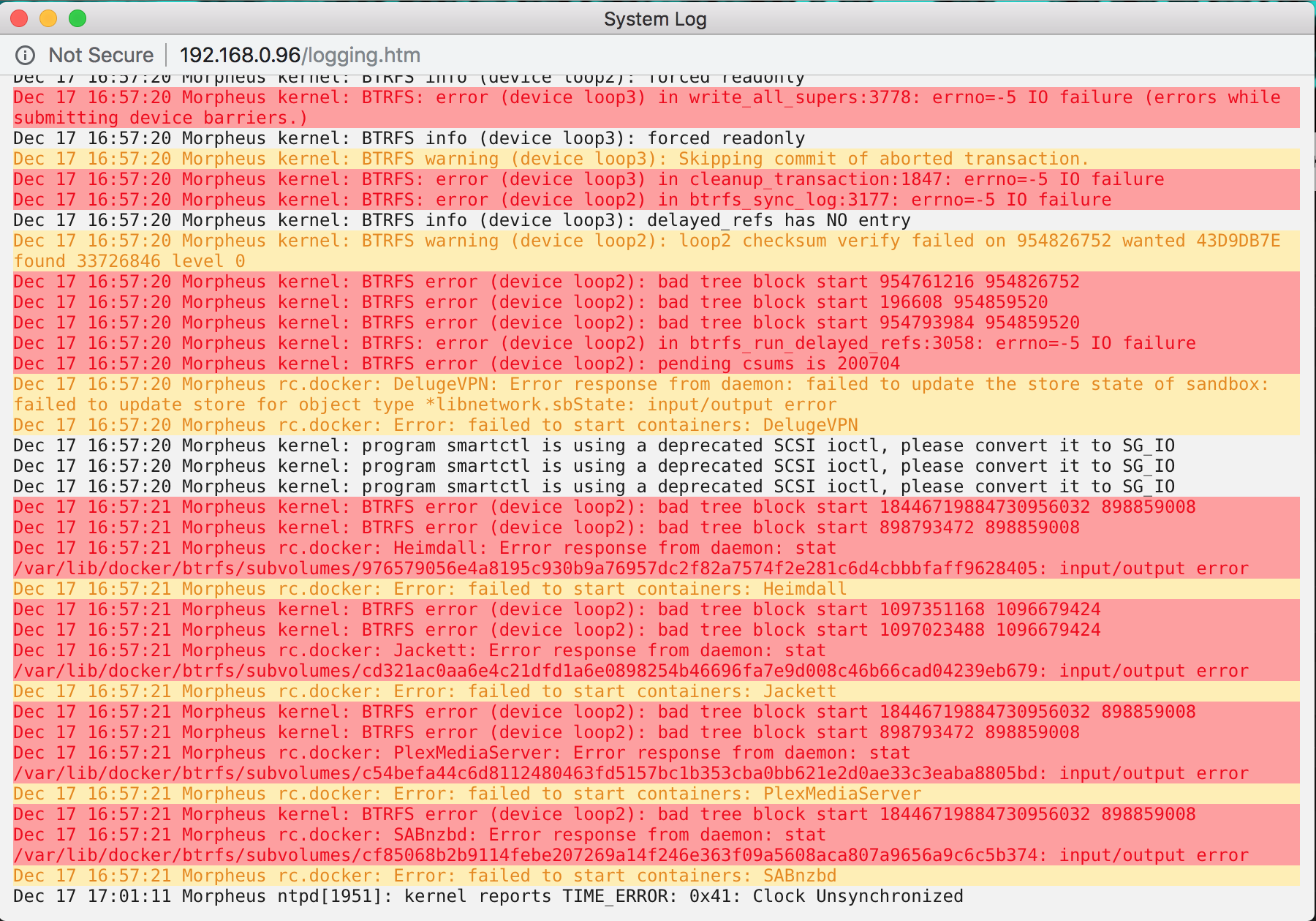

I am having problems with my cash drives, I sometimes get errors where Docker and VMs will not load in the web UI, When I look in my log I get
BTRFS error (device loop2) : Bad tree Block start.
This requires a complete reboot of my server. The problem then goes away for about 2 days and then comes back again.

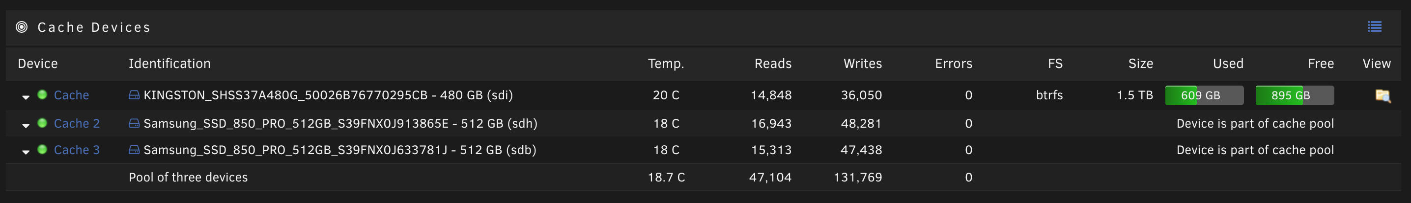

As you can see I have 3 SSDs which are configured in software raid 5 for speed for VMs and so that each SSDs would share the loads. Do I need hardware raid which i found SilverStone SST-ECS01 https://www.amazon.co.uk/dp/B00NNPKOLE/?coliid=I17W5DQF5EQCG9&colid=13QNL4KHHVIHI&psc=1
I have run a smart test on all 3 SSDs and the array and i get message Completed with out an error.

Go to Tools - Diagnostics and attach the complete diagnostics zip file to your next post.
Unfortunately diags are after rebooting, but looks like a cache device is dropping offline, though not seeing any btrfs stat errors on mount, and they usually appear when there are some, still check with:
btrfs dev stats /mnt/cache
If all zeros grab new diags before rebooting if/when it happens again.

Cache1 dropped offline:
Jan 25 18:39:23 Morpheus kernel: ata8: hard resetting link
Jan 25 18:39:28 Morpheus kernel: ata8: softreset failed (1st FIS failed)
Jan 25 18:39:28 Morpheus kernel: ata8: reset failed, giving up
Jan 25 18:39:28 Morpheus kernel: ata8.00: disabled
At the same time cache2 dropped offline:
Jan 25 18:39:28 Morpheus kernel: ata7: softreset failed (1st FIS failed)
Jan 25 18:39:28 Morpheus kernel: ata7: reset failed, giving up
Jan 25 18:39:28 Morpheus kernel: ata7.00: disabled
Jan 25 18:39:28 Morpheus kernel: ata7: EH complete
Cache pool can't continue to work with two devices missing, check cables on both devices, there could also be a problem with the Asmedia controller.

I would suggest testing with a different controller, both devices going down at the same time suggest a controller problem, or anything else the devices share, like a SATA power splitter, etc.
Edited by johnnie.black
Hi thanks for taking a look at my diagnostics my SSDs and the ray both connected directly to my motherboards SATA ports so if it is the controller than i think might need a new motherboard.
Those two SSDs are connected to an Asmedia controller, it might be onboard but it's not the main 6 port Intel SATA controller, you can always buy a similar ad-don two port controller and test.
