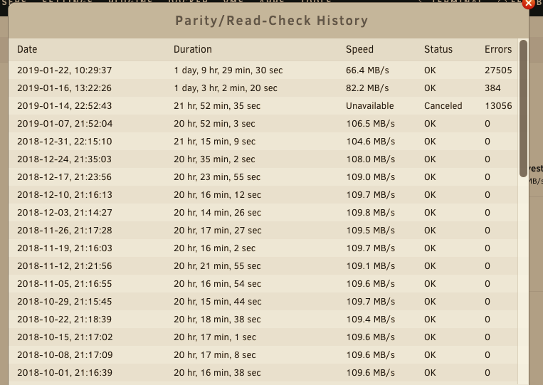

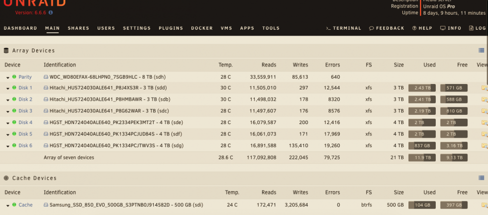

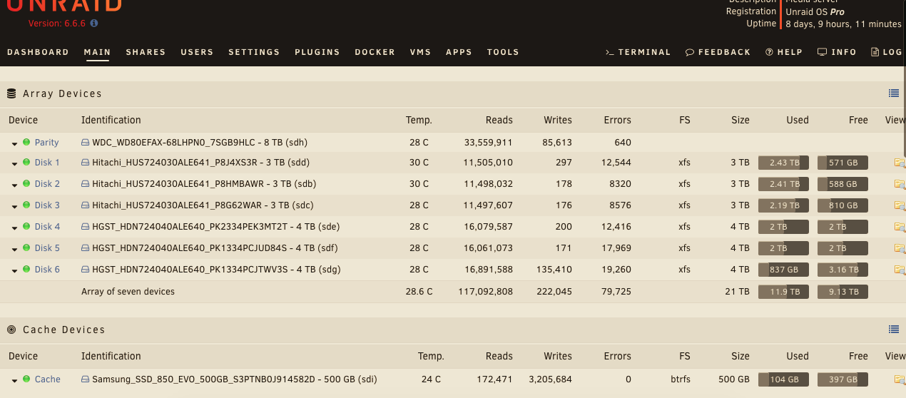

Hi there, I was on 6.4 (I believe) for the longest time and recently updated about a month ago. I started noticing disk errors starting to pop up, got concerned and updated to the latest (6.6.6). But the errors are still continuing to increase but the SMART data is showing no errors logged. The parity drive is a bit more than a year old (8tb wd red), while the remainder are nearly 4 years old (1-3 enterprise drives, 4-6 nas drives). Should I be concerned and if so, what should I do. It literally went from 0 across all drives to all drives showing errors. Thanks in advance!

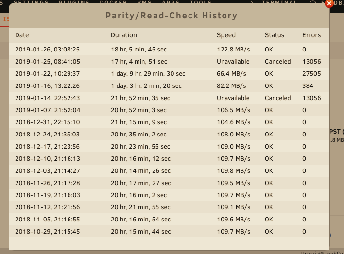

So I tried running a parity check without corrections one more time before doing anything and it was running slower than molasses. Did a diagnostic report. Pulled out all the sata cables, and connected two breakout cables from the lsi sas card to the 8 drives. Ran a parity check with no error correction and it's coming back clean with the fastest time to boot.
