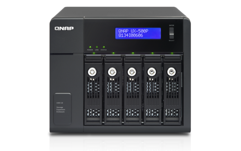

I've just been migrating away from QNAP due to the cost of their hardware when you need a decent CPU / docker / VM etc.  I had a QNAP 669-L and a UX-500p cabinet.  After copying all my data off, I thought I'd just plug it in to my Unraid box to see if it saw it and after a bit of disbelief, it does!  All the disks show up individually and are able to be assigned to the RAID etc.  The screen is stuck on 'system booting' which doesn't seem to affect performance obviously, but that's about the only glitch I can see.

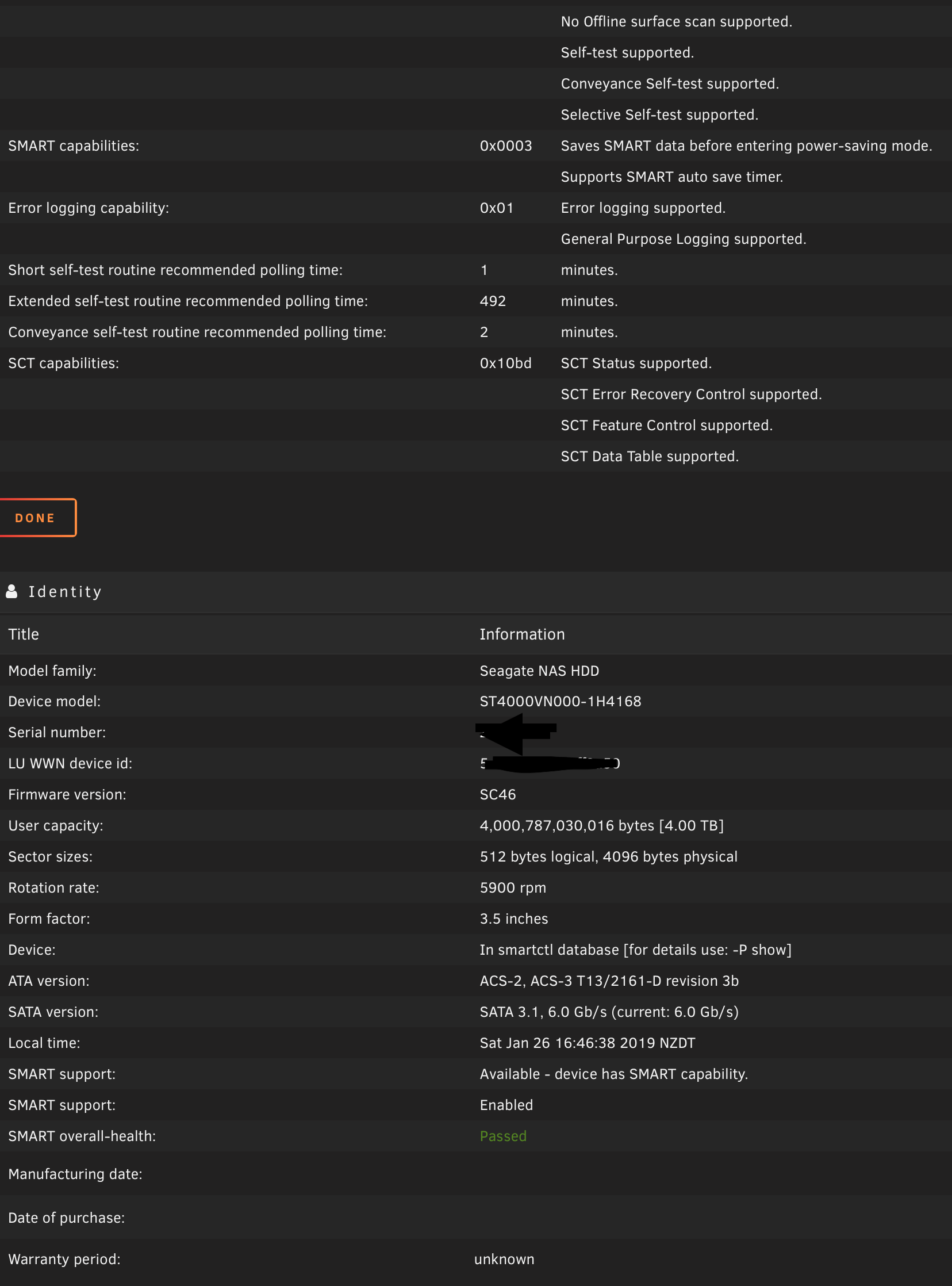

Does SMART info. can read ?

I've just put some of the disks in it, into my main machine via a Dell H310 Card.  I was going to wait until the party was done before playing around with it again, however being USB I can probably do it.  Will let you know - I think I did see smart info but need to double check.

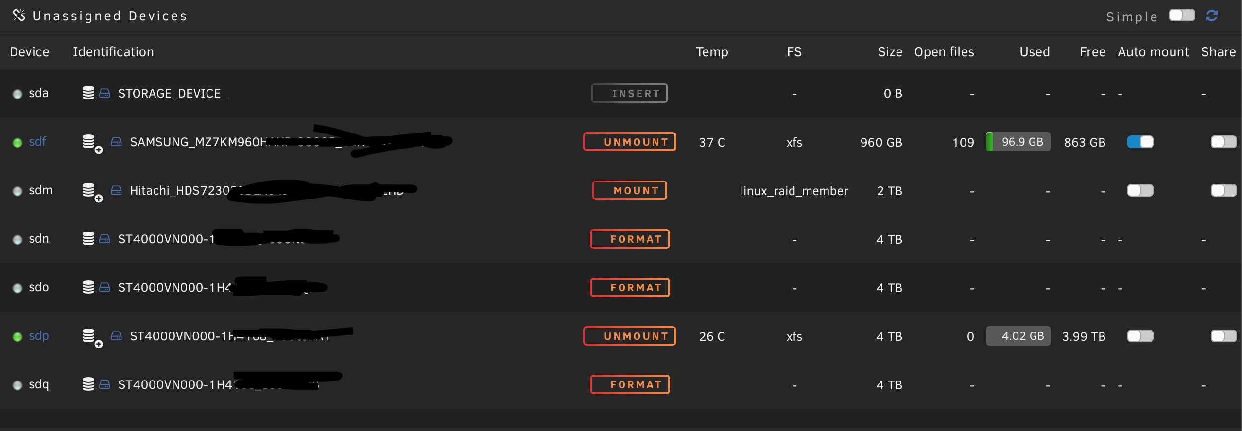

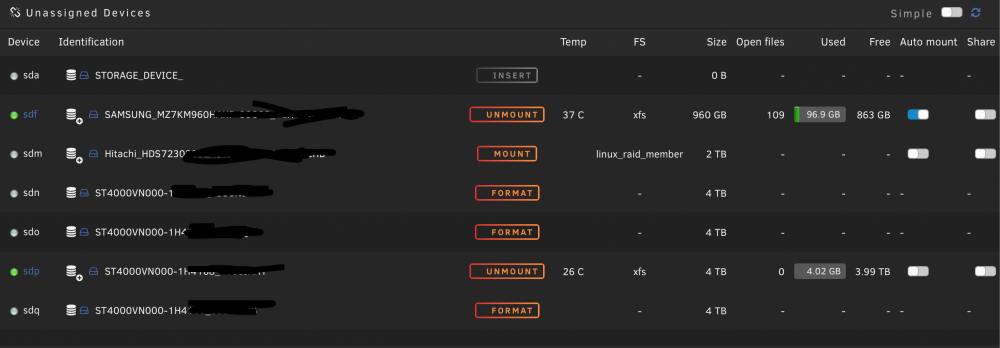

I've just plugged it in again (live hot plug while system running with a set of different disks).  I can see all the smart info, temperatures and everything.  It looks EXACTLY like any other disk to me.  I'll try a speed test too - but given Unraid is really only good for gigabit network, it's not going to suffer that kind of speed.
I don't want to actually put a disk in my array for obvious reasons, but I'm just connecting it through the unassigned devices plugin.

Suppose sdm - sdq ( 5 bay ) was that, seems good.

It doesn't work with the disk speed container though - I expect that just how the container is written, probably doesn't work with USB drives.  Yes drives sdm to sdq are the external disks.
Also confirmed, auto power down of drives works.
