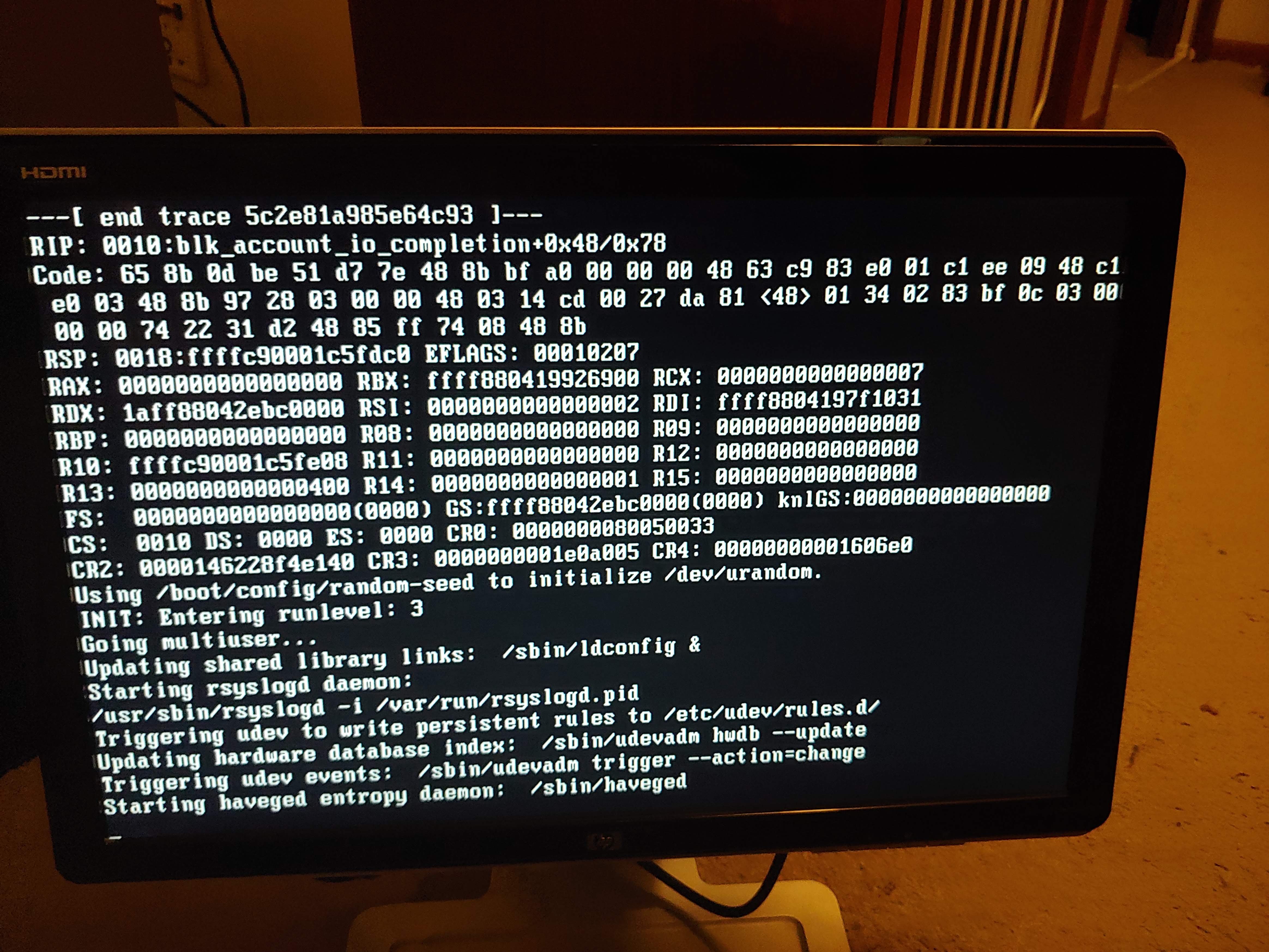

Saw this when I hooked a monitor up.  Any ideas?
I figured out the issue.  It was the fact that I had my shucked 10TB WD HDD plugged into my new Mini SFF 8087 to 4X SFF 8482 Cable.  Even though the power connector going into it didn't have a 3.3v line, the pin being connected to the drive was enough to mess it up.  Working fine now.  Other than my SSD not wanting to trim, but I'll figure that out another day.
