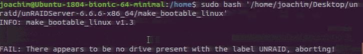

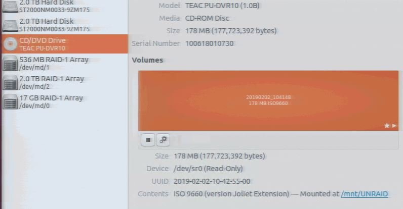

I have installed a version of unbuntu now and i can see the usbdrive. But it is not showing up as a usbdrive on the desktop. It looks more like a cdrom or something. So now im really confused.

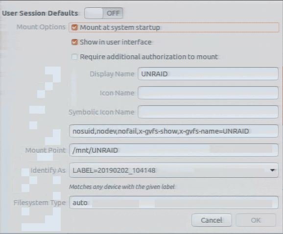

When i try to run the command "sudo bash" and copy the file from where i unzipped it to the terminal. it is now saying "FAIL There appears to be no drive present with the label UNRAID, aborting"
It was not called UNRAID from the beginning. I have changed the display name but it is still not working.

Perhaps it's a language barrier issue, but you will have to have a physical USB drive with a valid unique GUID to license unraid. That sentence makes me think your host is setting up a virtual drive for you to use, which will not work.
