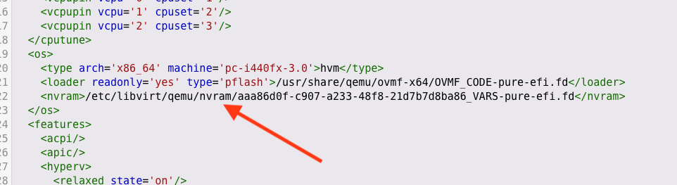

That’s a good question. If it does, you could always go back and copy the nvram from the old server to the new one, and make sure the uuid matches the original. Then it would essentially be the the same I believe, alleviating the problem.
OK. Thanks @1812. I'm going to have to research that. I'm not sure where the nvram is stored. I'm not a big VM user.
The vm xml shows you:
