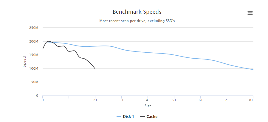

I used the DiskSpeed plugin and got these results.  Looks decent from what I can tell - at least 100MB/s based on the test itself.
yes, but this plugin tests only read speeds..
Ah understood.
