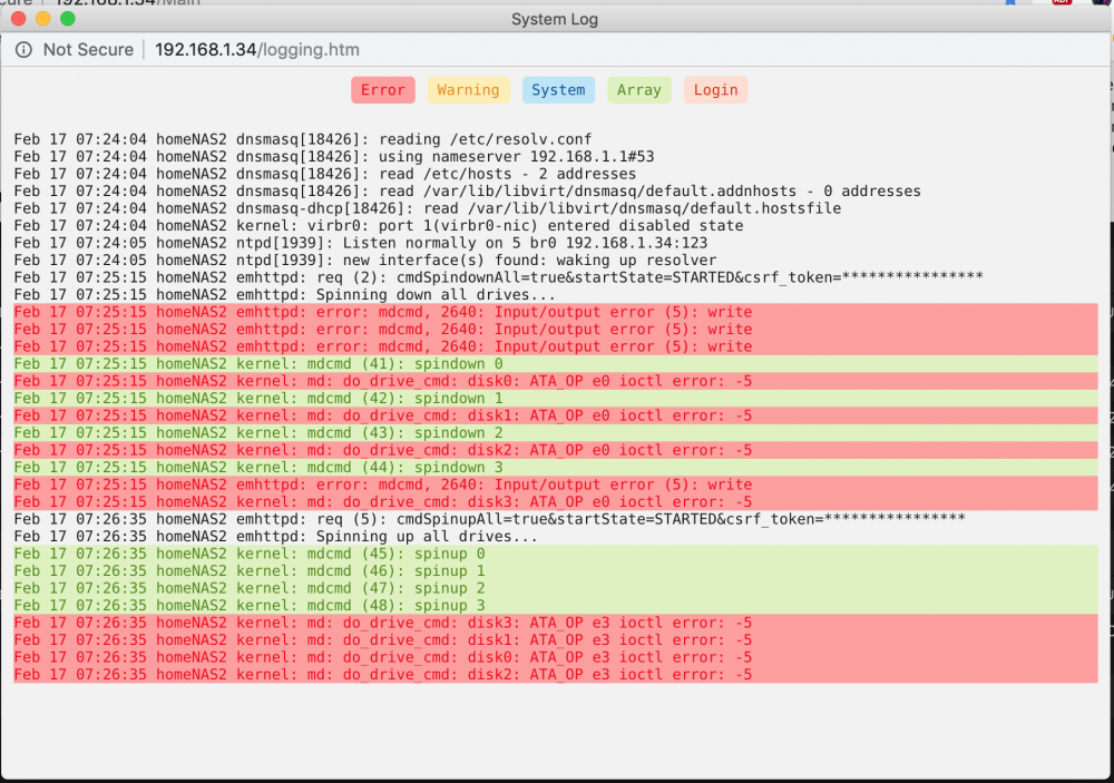

Put together an Dell R710 with a Dell H310 6Gbps SAS HBA w/ LSI 9211-8i P20 IT Mode and drives showed up as expected but I'm getting an error with spin down when I hit spin down the temp indicator turns to an asterisk as expected but error is logged any ideas

Unraid can't currently spin down SAS drives, you should disable spin down to get rid of the errors.
Ah good to know figured it would be something along those lines this will eventually be converted to sata drives, so I'm guessing the smart error I'm getting is somewhat related? these drives came with the server so I don't know their history
Yep, you can check the SMART reports on the diags, but SMART info for SAS drives is very different than ATA drives.
