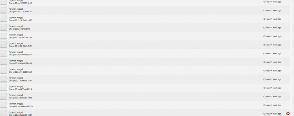

for a good while I have to increase my docker .img  several times I am currently up to 150GB. but what I have found is a lot of orphan images under the docker /advance with only IDS. so I delete a couple and my image size decreased .I can I find where they are coming from and a easy way to delete .thanksunraid.thumb.PNG.17a858ec9af735e0e02d5488920688f0.PNG
Orphan images come from when there is an error starting the container.

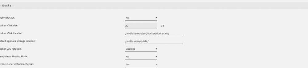

Go to Settings - Docker, disable the docker service, delete the docker image, and recreate it at the more reasonable size of 20G.
6 minutes ago, Squid said:
But post the screenshot I asked for first
okay got it done.
