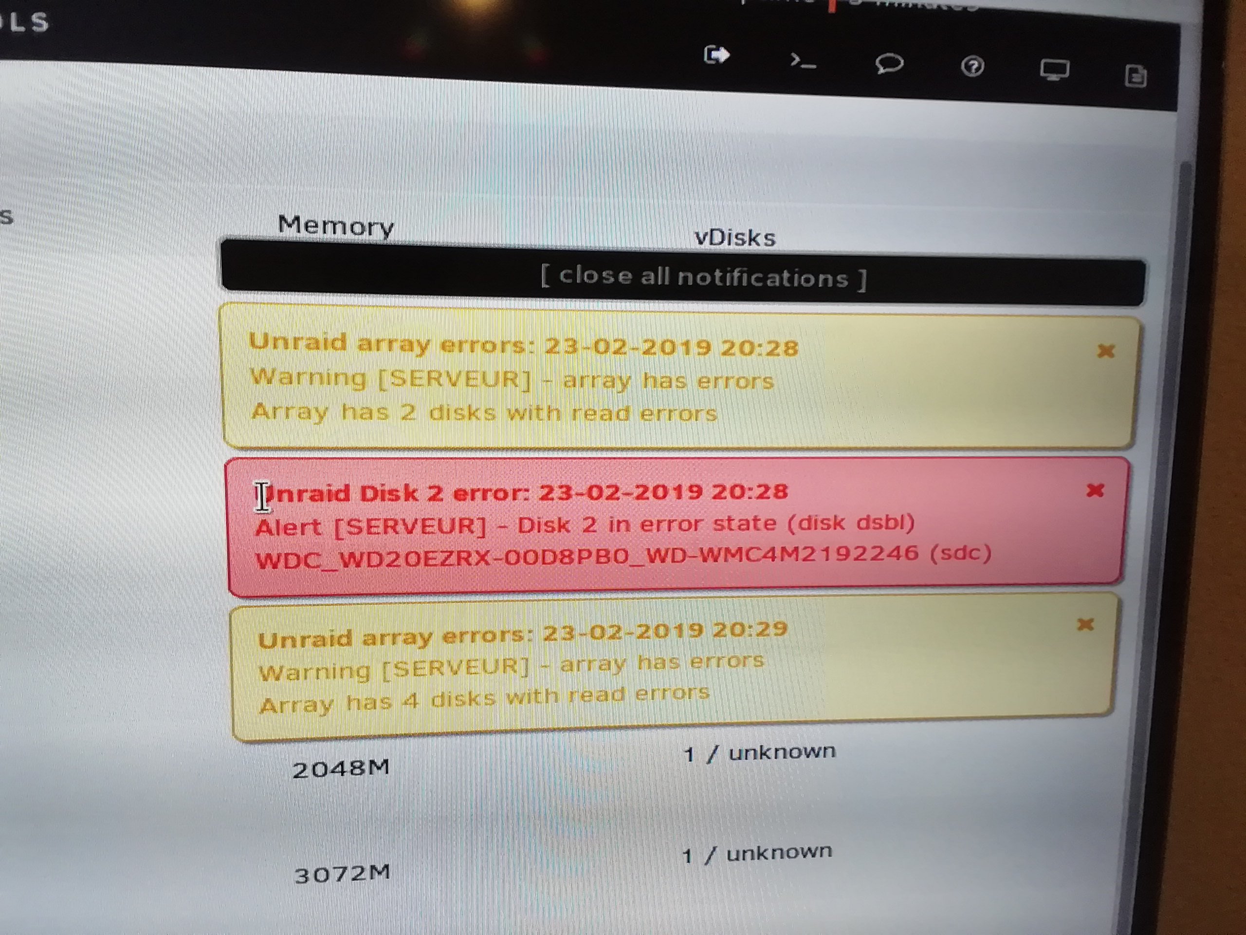

BUT when I try to start libvirt it cause the array to crash with drives going faulty and VM and isos storage being unavailable.
all drives then go to unassign devices
I really don't understand what is happening

Feb 23 20:18:28 Serveur kernel: md: disk0 read error, sector=972118240
Feb 23 20:18:28 Serveur kernel: md: disk1 read error, sector=972118248
Feb 23 20:18:28 Serveur kernel: md: disk2 read error, sector=972118248
Feb 23 20:18:28 Serveur kernel: md: disk3 read error, sector=972118248
Feb 23 20:18:28 Serveur kernel: md: disk4 read error, sector=972118248
I got this repeat after trying to start libvirt

So I'm able to start libvirt and create VM's if I do not load my old VM's by changing the default storage path
So my guess is an "old" VM is causing the trouble
maybe I did let one in autostart
So new question how do I disable an autostart VM without starting libvirt?
thanks

but I figure this out by deleting the libvirt image and rebuilding all my vm's
so problem solved I would say
