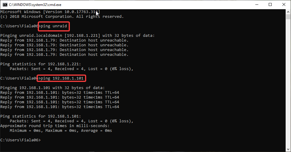

Pinging hostname results in unreachable but dir IP works fine

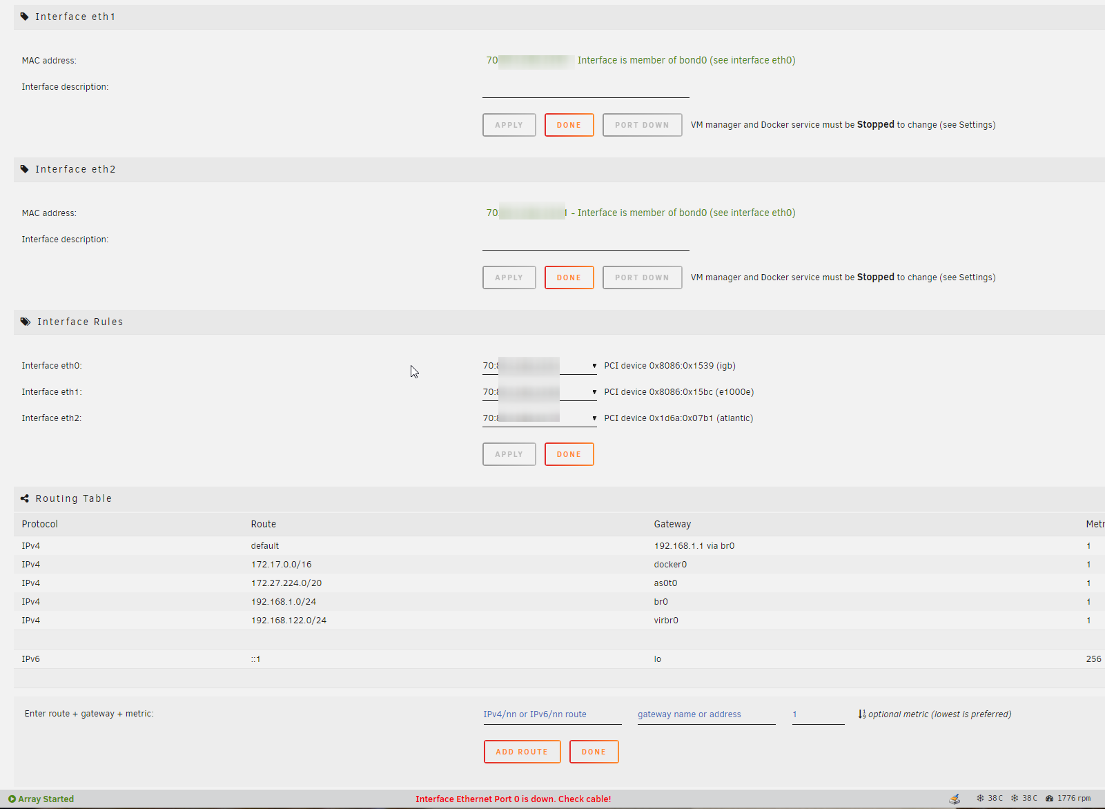

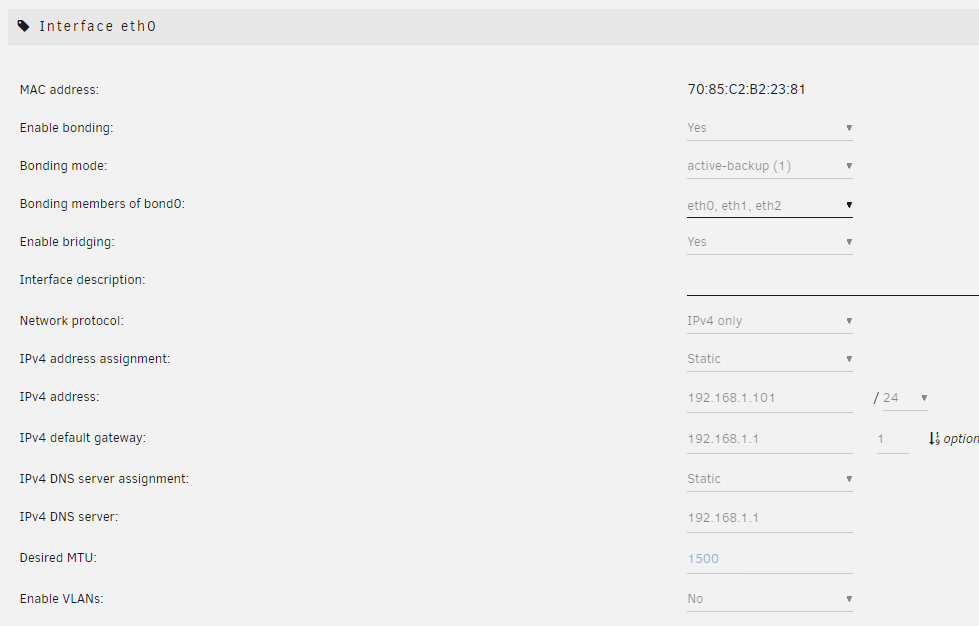

Unraid etho

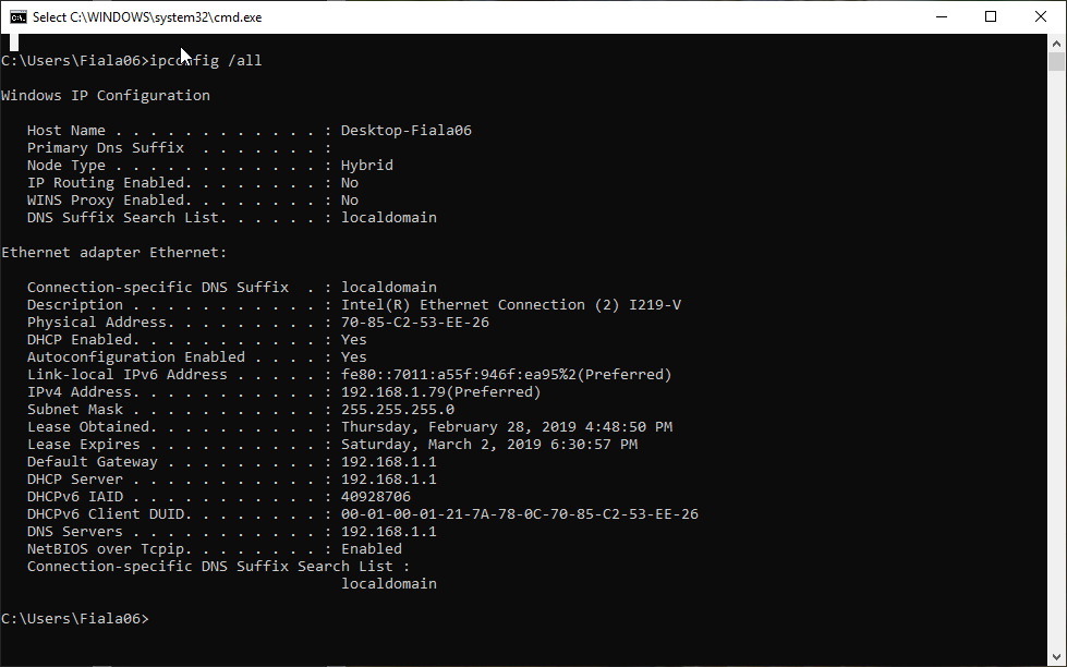

My primary desktop (physical machine)
