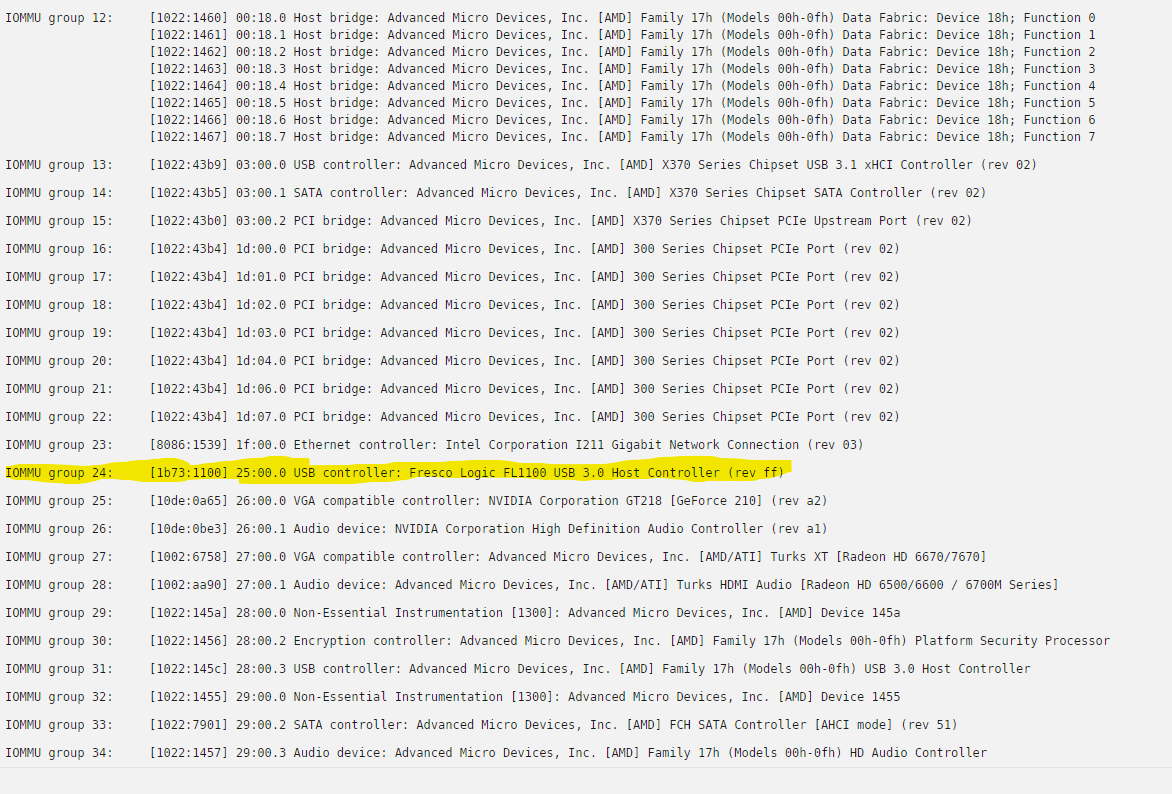

If I set the PCIe ACS overACS override to both it isolates the card

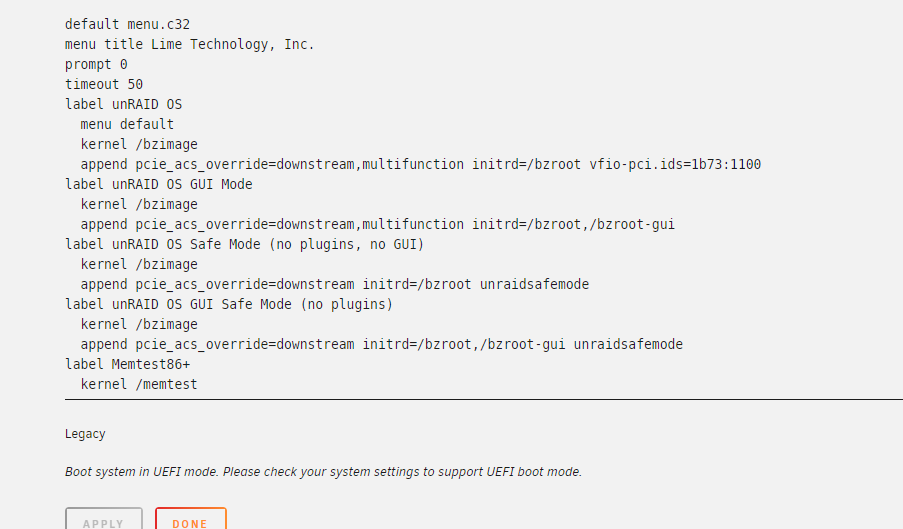

And after stubing "1b73:1100" in the Syslinux configuration

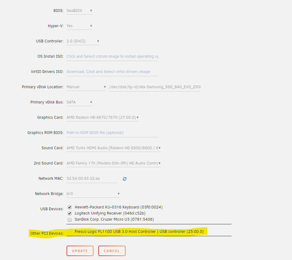

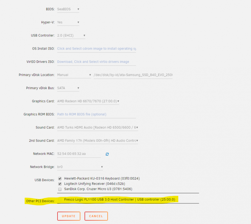

The USB card shows in the available pci devices
But after selecting the USB card and booting the W10 VM it sometimes hangs on boot and need to be forsed to stop and when it does start I can see the card in device manager and have loaded the drivers but when I plug in a mem stick it shows in unraid and not on the VM?
