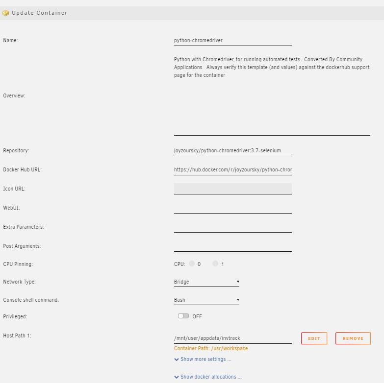

I enabled docker hub searches in Unraid's Community Apps and found and downloaded "python chromedriver".  I then edited the docker parameters as  shown in the attached image.
When I attempt to start the docker with network set to host I get nothing in the logs.  If I set it to bridge I see the following (2 start attempts) but the docker does not come up.  Interestingly when I got this docker working outside of Community Apps by just doing the above docker run command, the Unraid docker page  shows it as having a "default" network which isn't an option when I add it through Community apps.:

So I'm looking for some feedback on any potential errors I've made in adding the docker via Community Apps that are causing the docker to not start.  Would also appreciate any tips on how to kick a script inside my docker once it is running, and how to run a setup script (to pip python modules) inside a docker on startup.

Your best course of action is to compare the docker run commands between when editing the container and what you used to run at the command line and then making adjustments accordingly
Thanks squid.  Turns out it was the "-it" options.  Now the docker starts as expected.  I also was able to hook it up to cron via the docker run command.
