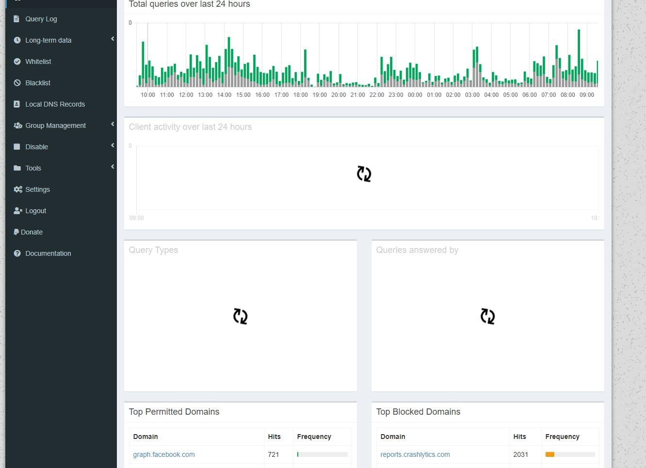

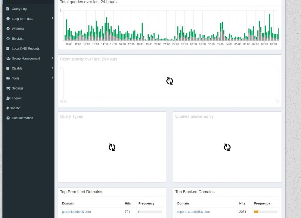

  10. FTL wasn't working either for me which was fixed by writing to the port file. SHIFT+F5 in Brave fixed the display problem for me.
  11. Had to clear my browser cache for the pi-hole and "echo 4711 > /var/run/pihole-FTL.port" in the pi-hole docker console.
  12. Pi-hole was working great with version 5.0. I just updated to version 5.1 and now I see this permanently on the dashboard. Anyone else seeing this? Ad-blocking appears to still be working, so the issue is just a reporting one vs. core functionality.
