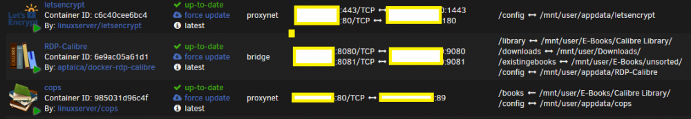

I've tried installing this a few times.  When I try to hit the WebUI, I get a blank page.  The NGINX error log shows this:
2016/08/28 11:38:31 [error] 255#0: *1 open() "/var/www/localhost/cops/api/tokens" failed (2: No such file or directory), client: 192.168.0.210, server: _, request: "POST /api/tokens HTTP/1.1", host: "192.168.0.202:8080", referrer: "http://192.168.0.202:8080/"
2016/08/28 11:38:31 [error] 255#0: *2 open() "/var/www/localhost/cops/app/home/templates/home.html" failed (2: No such file or directory), client: 192.168.0.210, server: _, request: "GET /app/home/templates/home.html HTTP/1.1", host: "192.168.0.202:8080", referrer: "http://192.168.0.202:8080/"
Note, I changed the external port to 8080 as it is my understanding leaving it set to 80 would prevent me from getting to the unRAID webui.
Thanks,
D
Only change the host port, not the container port.
Can you post a screenshot of your port mappings etc...

Also, any recommendations on getting the files into the share?
I tried to use Calibre on my Windows box and have it use the share, but I'm just getting errors when I try to import.
I'm guessing I'll set everything up on my pc then move all of it into the share, but there has to be a better way.
Sent from mobile
I personally have my Calibre library on Unraid and use a Calibre docker to access it, both aptalca and Sparklyballs have a version.  In the past I've successfully used a Windows box to access this Calibre database, but it must be on a mapped drive, (ie mapped with a drive letter within Windows)
Thank you. I looked at the config file I didn't see the language parameter, but that happens often enough (my wife would say I can go to the beach and not find the ocean).
I'll give a calibre docker a shot. Calibre website warns not to use a network drive...
I am using Aptalca's RDP-Calibre docker and it is awesome.
You get both the "desktop" version of Calibre, and a web based one to access your books from your device. Here is my config page for it. I think I added a few paths and variables... the /library one is where all by books are stored along w/ the database. You access the "desktop" version in your browser via a VNC remote desktop connection. There is no longer a need to have a Mac or Win version of Calibre.
The /library folder has stuff like this:
If you use the Mac or Win version of Calibre, copy the database folder to the /library folder and then follow all my settings. There is one there for URLPREFIX, use that one only if you use reverse proxy.

I copied over my Calibre library and all my books how up in the Calibre interface when I rdp in.  However, when I go to the content server it says there are no books in the library.  I looked at the content server settings in the Calibre UI and it isn't even running (and the default port is defined), so I assume the content server in this docker is decoupled from the content server presented in the UI.  How do I get the content server to show what's in the actual Calibre library?
Map /books to the location of your Calibre metadata.db
