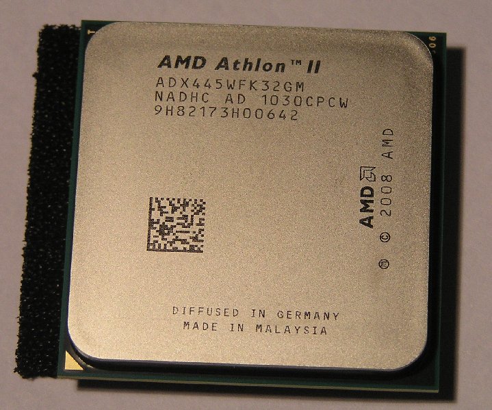

I got one because I just replaced my motherboard so I have an Asus M4A78L-M just sitting here.
FWIW, I put in the cpu and it unlocked it to a Phenom II X4 B45.  I'll have to prime95 it to be sure it's really ok.
