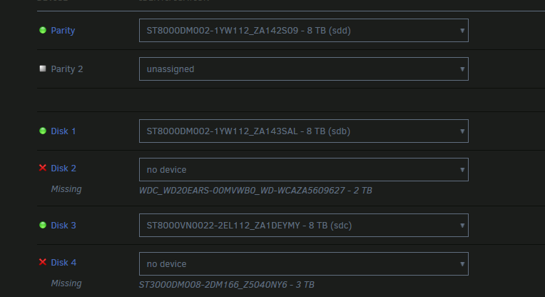

Attached a screenshot of the drives.
Disk 3 is the drive that can't be fixed, and disk 4 is the one they are attempting to clone.

Assuming disk2 is the one missing, when you get the cloned disk4 do this:
-Tools -> New Config -> Retain current configuration: All -> Apply
-Assign any missing disk(s) including cloned disk4 and a new disk2
-Important - After checking the assignments leave the browser on that page, the "Main" page.
-Open an SSH session/use the console and type (don't copy/paste directly from the forum, as sometimes it can insert extra characters):
mdcmd set invalidslot 2 29
-Back on the GUI and without refreshing the page, just start the array, do not check the "parity is already valid" box, disk2 will start rebuilding, disk should mount immediately but if it's unmountable don't format, wait for the rebuild to finish and then run a filesystem check
