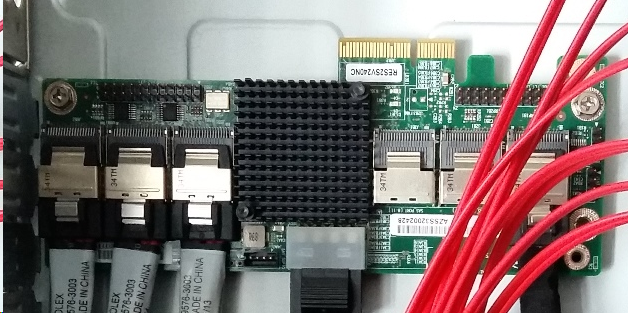

You'd need a SAS expander, for example the Intel RES2CV360
It's should be possible to mount it using one or more mb standsoffs, I did that with the smaller one, the RES2SV240
