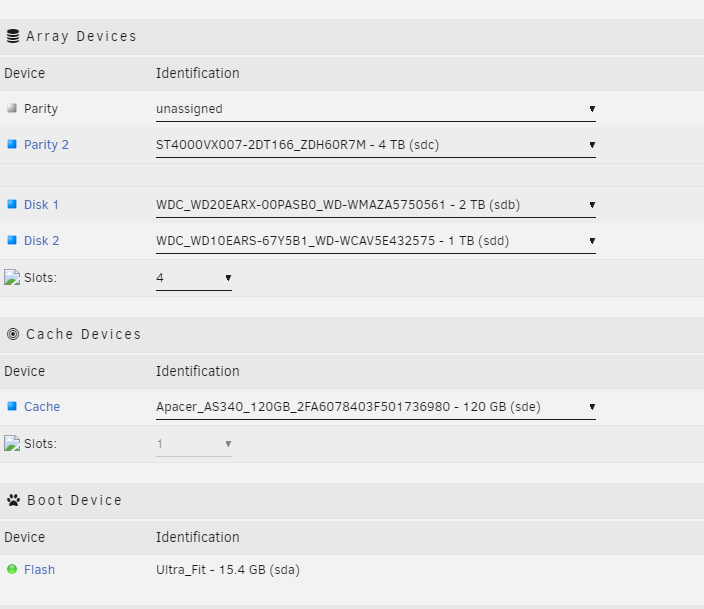

I've made a complete mess of replacing a data drive to make more room. Any help appreciated.
I have lost the array configuration, as I thought I needed to update it. Unraid now thinks all drives are new. The actual status of the drives is:
  • Parity 2 is the parity 2 drive.
  • Disk 2 is disk 2.
  • Disk 1 is the old parity 1 drive (but a disk clear started before I could stop it).
Is there a way to start the array so that Parity 2 and Disk 2 are accepted, and used to rebuild Disk 1? Is so, how?
Thanks in advance,
Glen
cupboard-diagnostics-20190402-0706.zip

Full confession on steps below. On reflection, I have no idea why I did what I did...
Array was originally:
2Tb parity
2Tb data (disk 1)
1Tb data (disk 2)
120Gb cache
The plan was to put in a bigger parity drive and use the old parity drive to replace disk 2.
Removed disk 1 and inserted new 4Tb
Pre-cleared 4Tb
Tried to mount Disk 1 again but was treated as a new disk. I didn't understand implications and disk rebuild started. For unknown reasons, server rebooted several times (it's an old machine). Couldn't find a reason for reboots, figured I'd corrupted disk 1, so went with copying parity (without fully understanding). No more issues with rebooting.
Mounted 4Tb as Parity 2. Completed parity sync.
Created new config with all disk assignments kept. Mounted Parity 2 in parity 1 slot (my OCD only exceeded by my ignorance), mounted old parity 1 as disk 1. Disk clear began on old parity 1.
Read up on parity disks, tried to put parity 2 back - created new config but lost the assignment for all disks.
Stopped and asked for help.
Even if I can just recover Disk 2, that would be better than nothing.
Edited by GlenM

I've remounted the original Disk 1 and 2 and at first glance, they seem to be OK.
I'm hoping that when disk 1 was treated as a new disk and a small amount of the data was rebuilt from parity, it was just rewriting exactly the same data and the disk is fine. It's not critical data, so can take the risk.
Thanks for help.
Edited by GlenM
