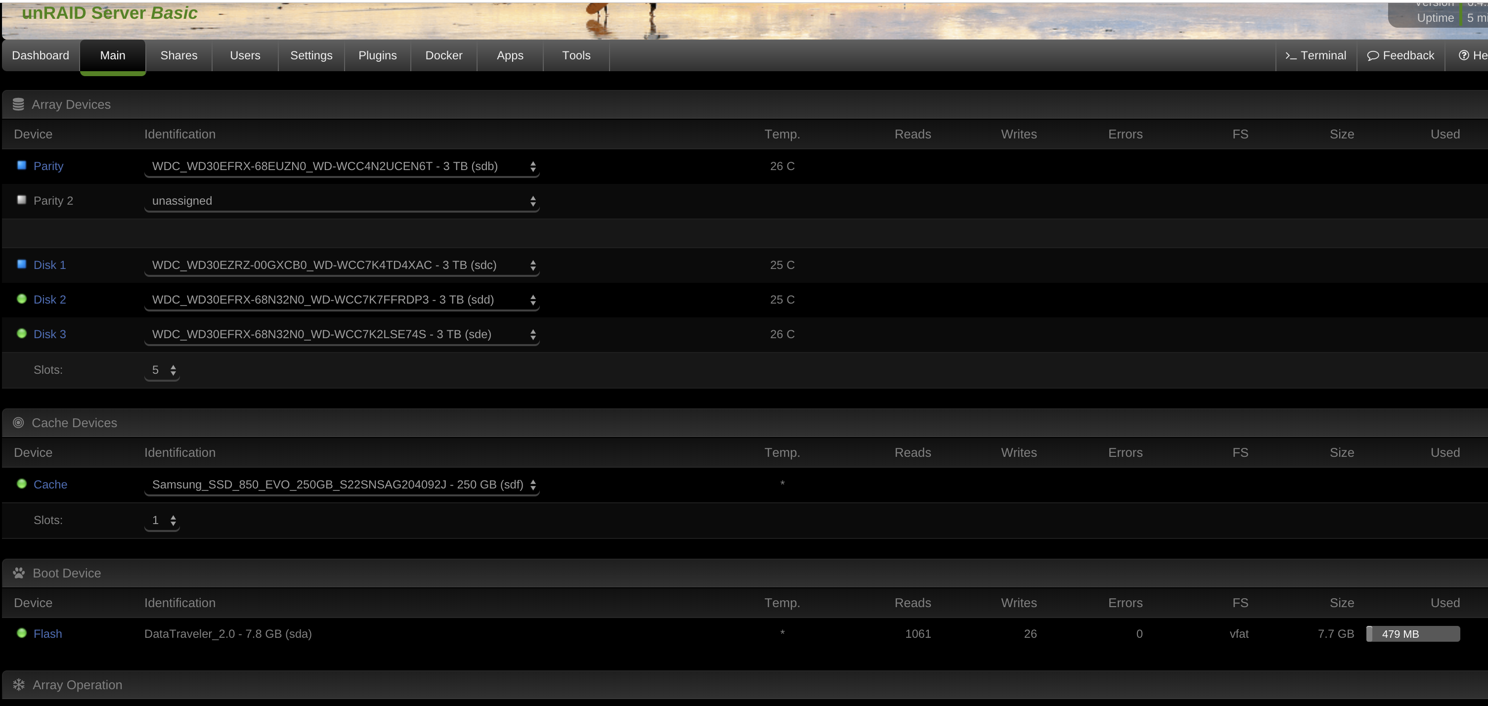

Post a screenshot of Main - Array Devices.
If you are absolutely sure about those serials do a new config, re-assign all disks and check parity is already valid, then run a parity check, if you're not sure also do a new config but assign all disks as data disks, there should be one unmountable disk, that will be parity.
Additional question - any way to remove the "Parity 2" entry if it's not needed?
When the array is stopped and it is ready to allow disk assignments as in your screenshot, then it will allow you to assign parity2. If nothing is assigned to parity2 then when the array is started parity2 doesn't appear.
gotcha - man thanks!
