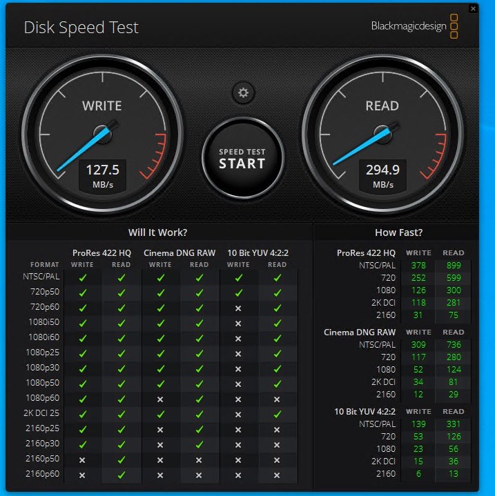

Yeah, so I'm getting proportions similar to iperf when transferring files to shares. Also similar results on Blackmagic Disk Speed Test (primary use for one of my VMs will be video editing once this gets worked out!). I'm writing to a share that is only stored on cache on these tests. I'm pretty sure before I updated to the beta I was getting good speeds. I attached a photo I took to show my buddy how nuts this setup is with a pcie 4.0 nvme drive.
I've made new VMs from scratch as well and still getting similar results.

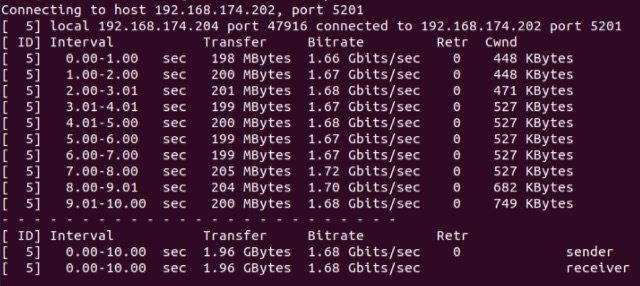

I set up a Ubuntu VM pretty quick and getting similar results. I could try reinstalling unraid back to the stable version to verify that everything was fast af. I was just having some issues with creating VMs with my hardware setup and the upgrade seemed to make things much smoother.

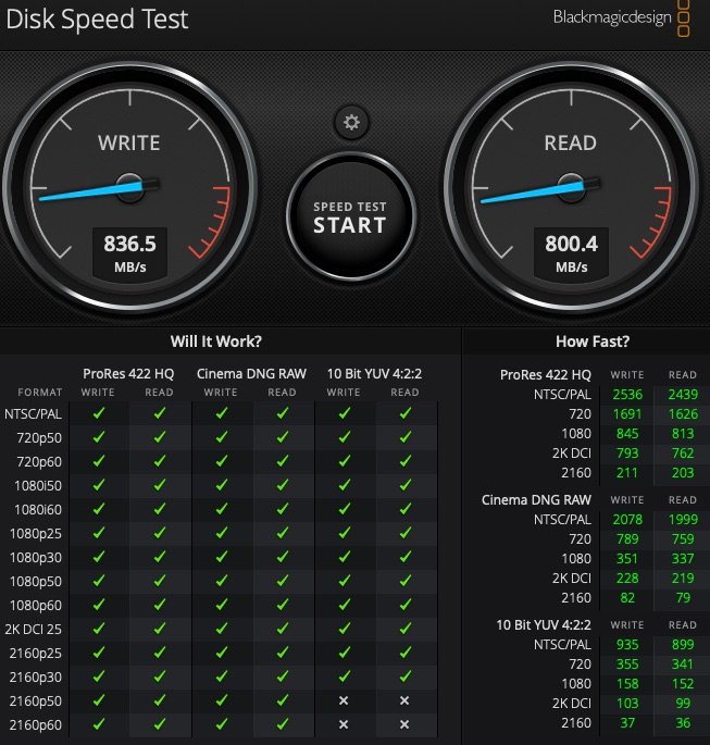

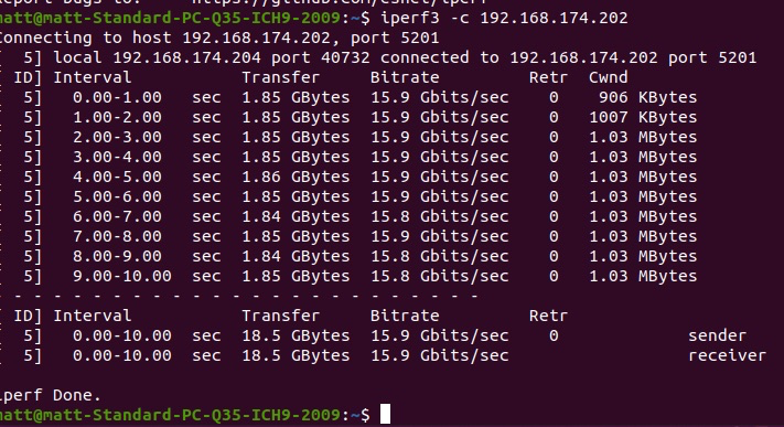

@jonp I can make a new thread if that is helpful, but I downgraded back to unraid 6.8.3 and results are confirmed to be what I expected. I did nothing else other than rollback via the GUI, then go to VMs and and I reselected a Q35 machine and boom, everything was fast again. (web vnc messed up but no big deal at the moment)
