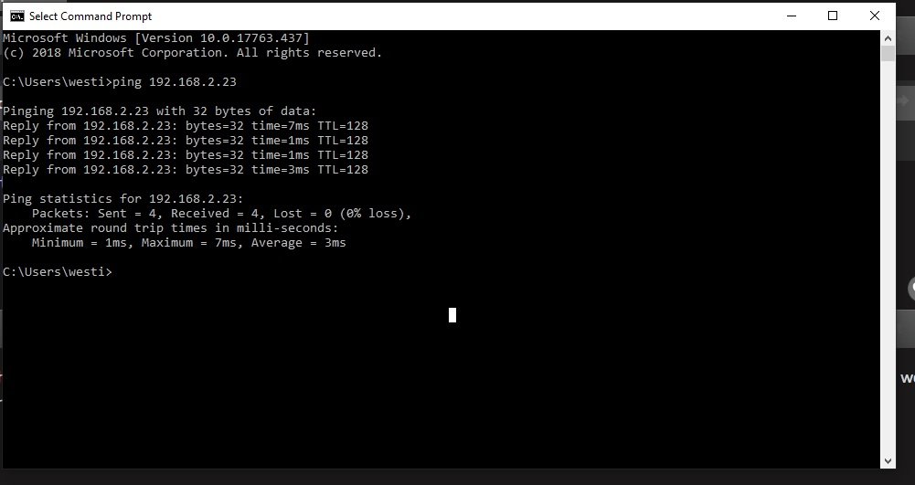

Does the VM IP respond to a ping?
I should also add that I had this same arma server working around a year ago on this same server. We had similar issues getting it working then but we did eventually get it working (unfortunately we can't remember what we did to fix it lol)
vm does respond to pings, and has internet connectivity

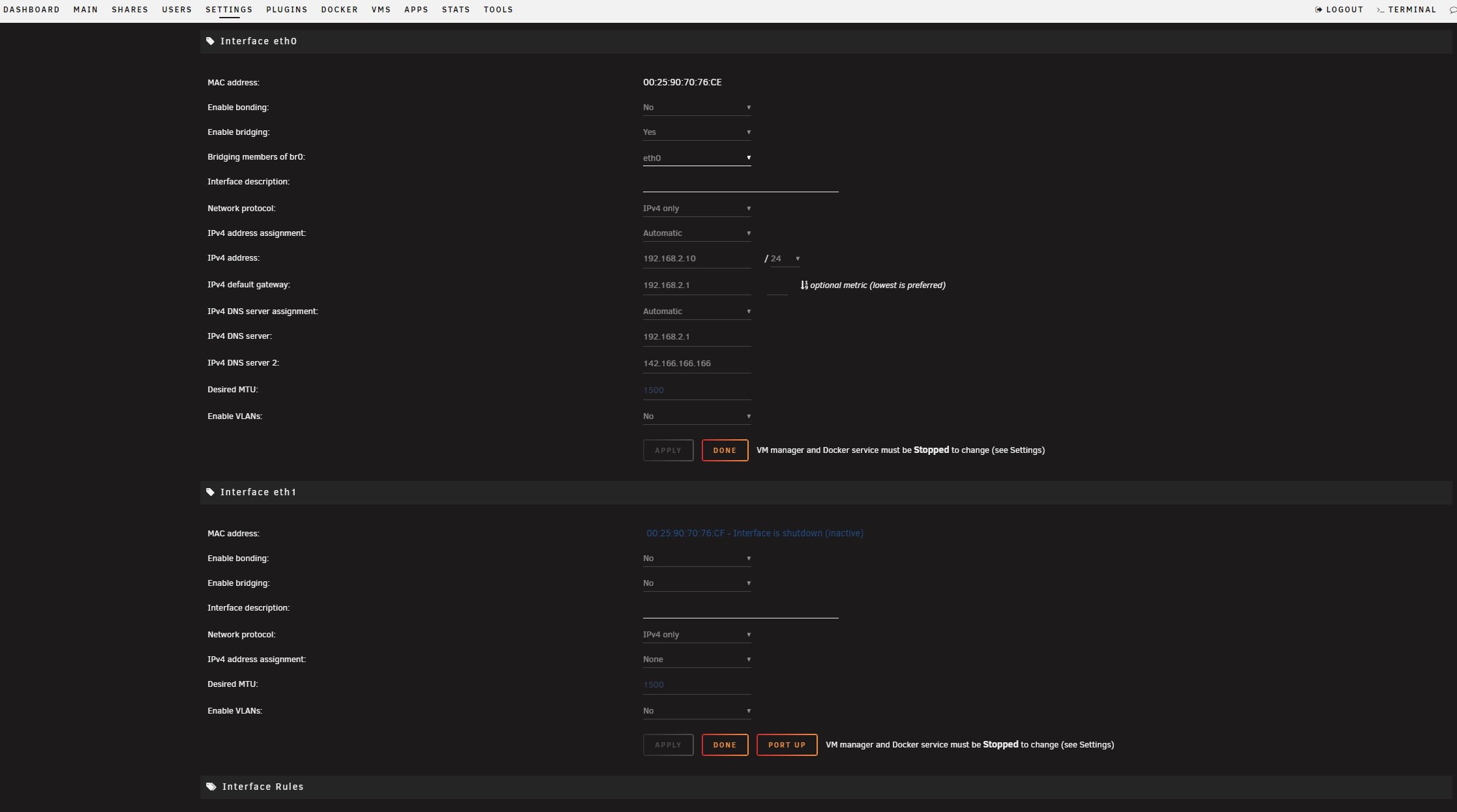

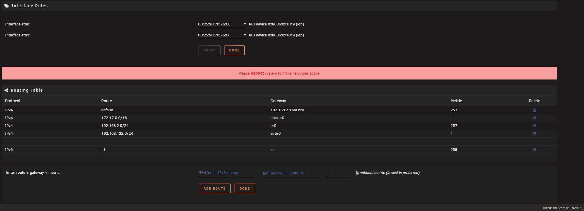

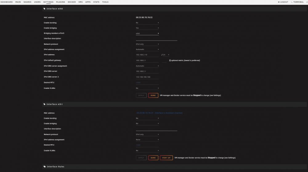

here is some screen shots of my network settings: (likely safe to ignore the message about rebooting for changes to take effect, that came up when i swapped the mac addresses between the two adapters, then back again once that message appeared, and i just haven't
restarted yet)
Edited by Drezdun
