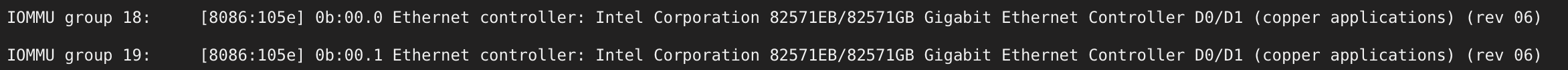

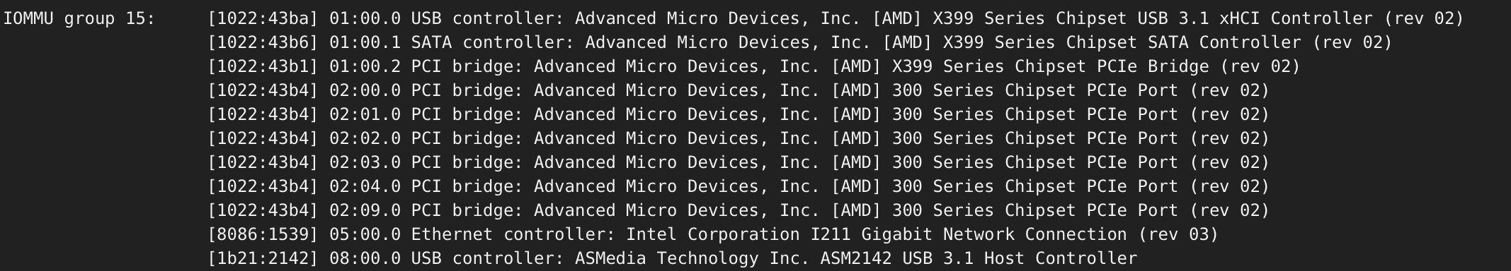

1063566963_ScreenShot2019-05-07at13_33_21.thumb.png.b0e95482ee3ed44dd63439ebcda93a33.png1542226412_ScreenShot2019-05-07at13_33_29.thumb.png.439ae77ffa2da69f67cafe702194089c.png

Mine looks like this now:
append vfio_iommu_type1.allow_unsafe_interrupts=1 pcie_acs_override=downstream,multifunction iommu=pt vfio-pci.ids=8086:105e initrd=/bzroot
