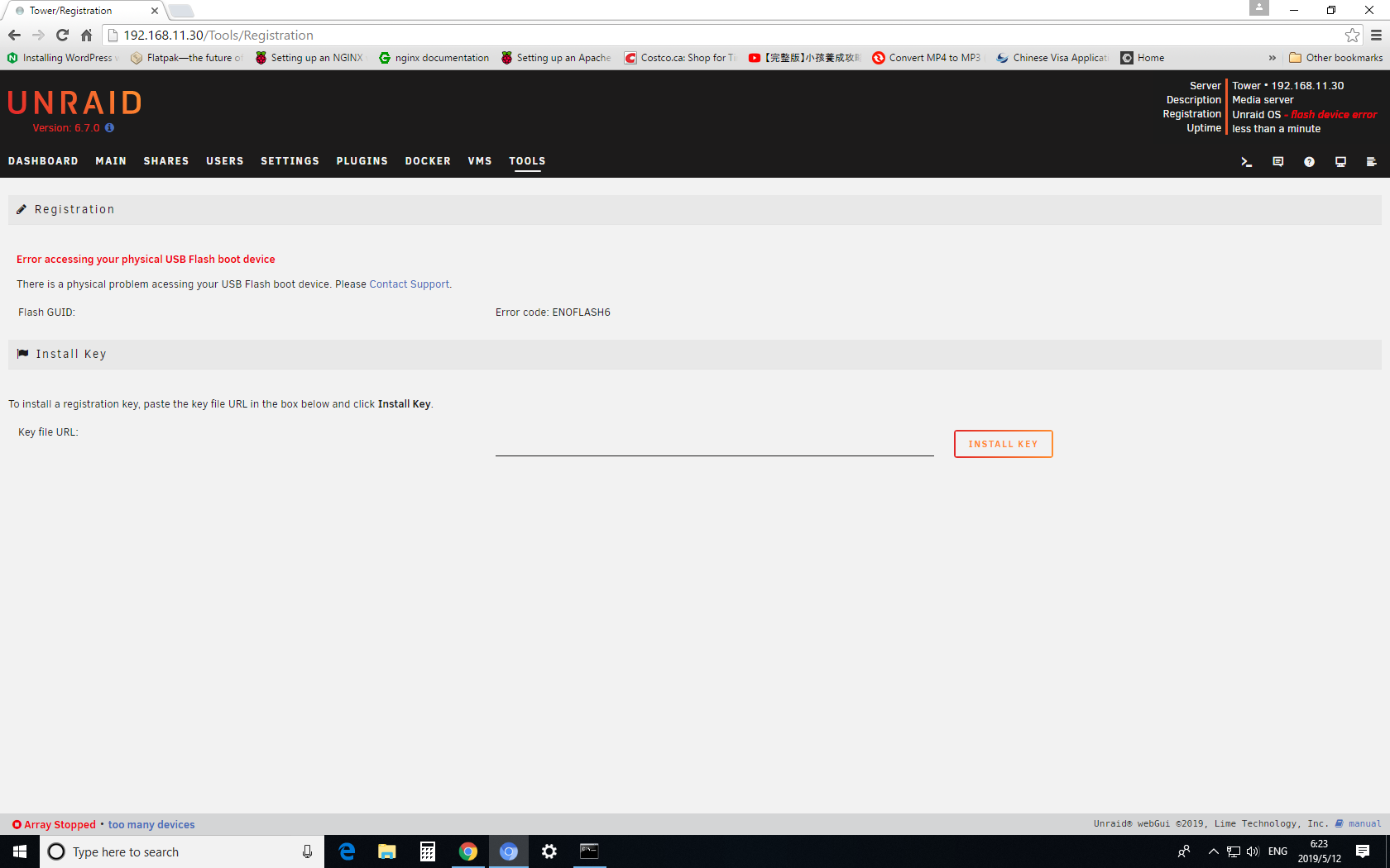

when I installed the unraid 6.3.5 that is working for register the flash device, but install the 6.5 to 6.7 version , the flash display error, can not register it to buy a key.

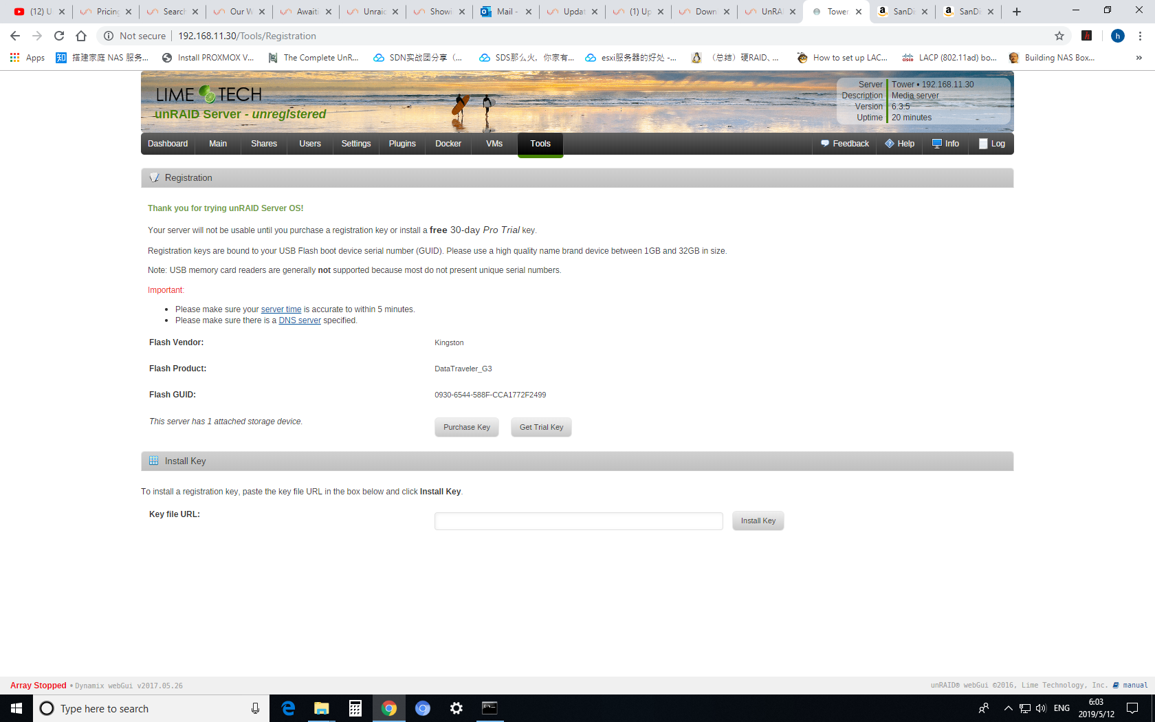

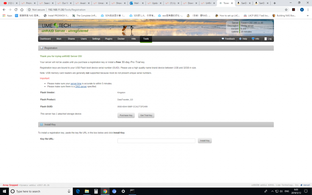

above img is 6.3.5 version that can see the flash guid, but on 6.5 to 6.7 version, can not show the flash guid
Strange - I have no problem getting the flash GUID displayed on all those releases :(   On all those releases it looks just like your screenshot.   Have you perhaps tried a different browser or white-listing the Unraid server in any ad-blocker you might be using with the browser you are currently using?
It might be worth showing a screenshot of what you see using the 6.7 release in case that provides a clue?
