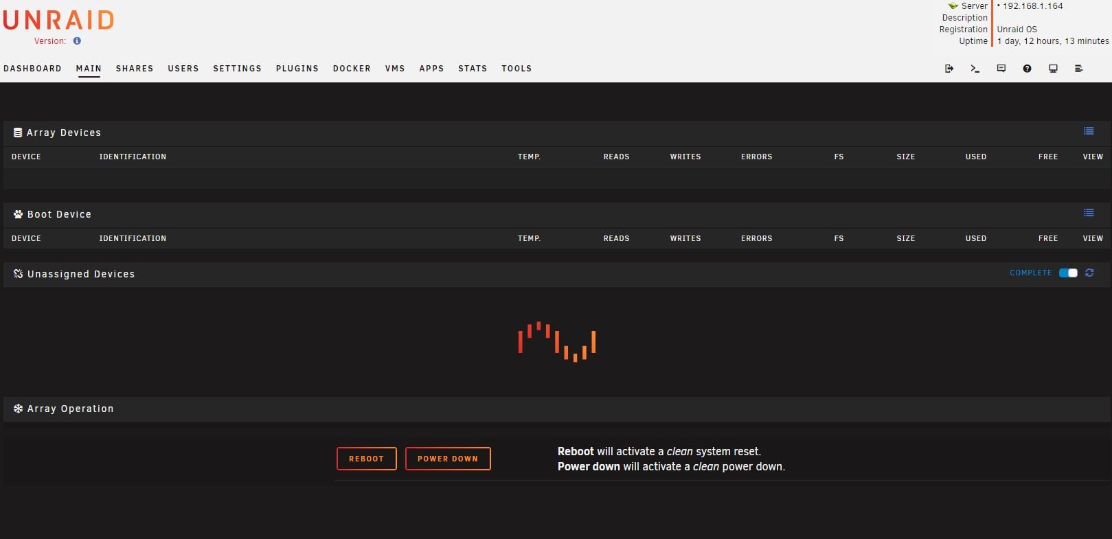

My UnRaid server went offline today. When i logged in i found
bringing up the log was empty

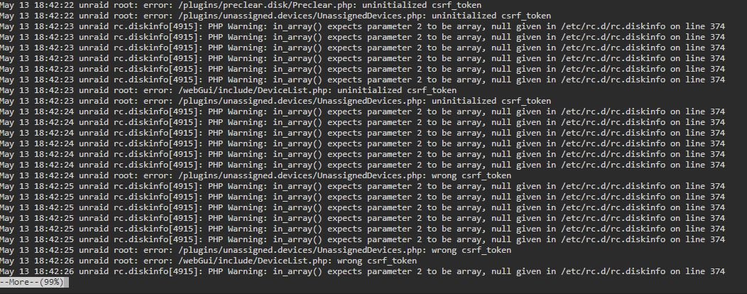

but accessing /var/log/syslog gave the following

You've got some uninitialized csrf errors which implies that your rootfs completely filled up. (A docker container due to misconfiguration saving stuff in RAM)
