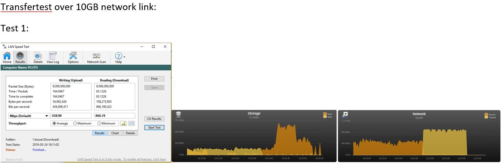

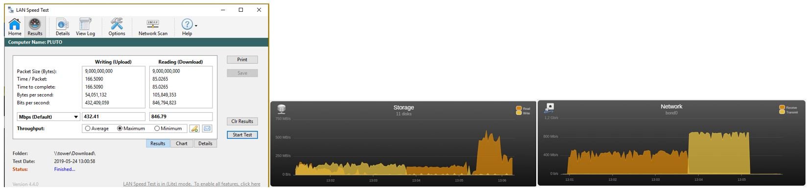

Initially I changed the bond and interface assignment to have the 10gig mellanox as eth0 with eth3 (the old primary utp 1gig) in the bond.
When I set it up like that my transfer speeds seem to be limited by the speed of eth3..

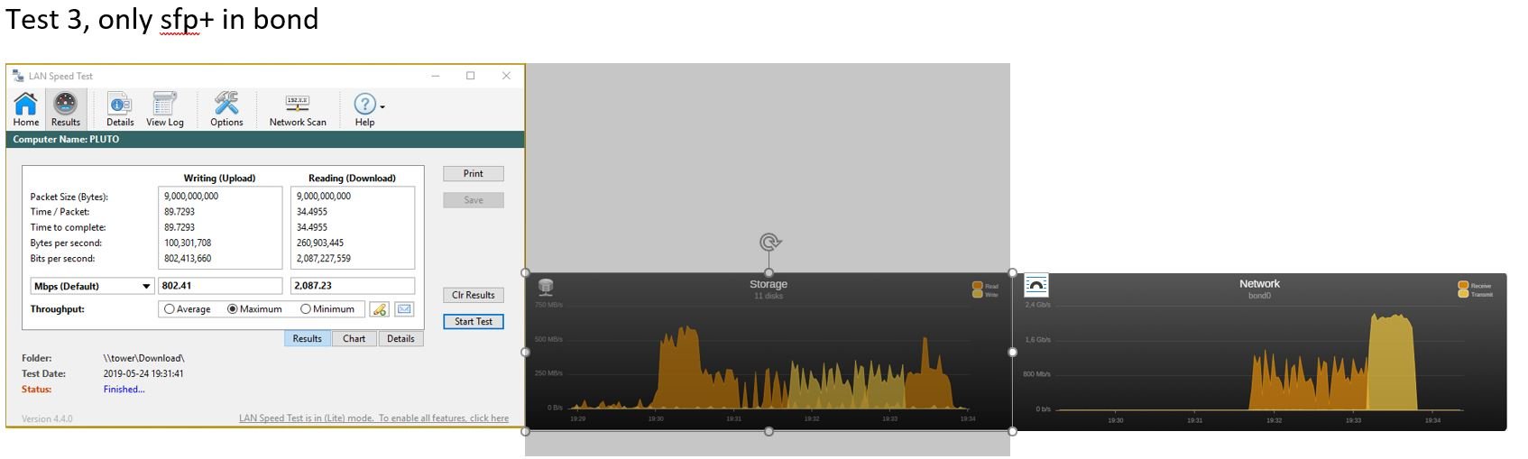

I solved this for now by removing eth3 from the bond (having a bond now with only eth0 in it), this works and gives a big increase in transfer speed.
