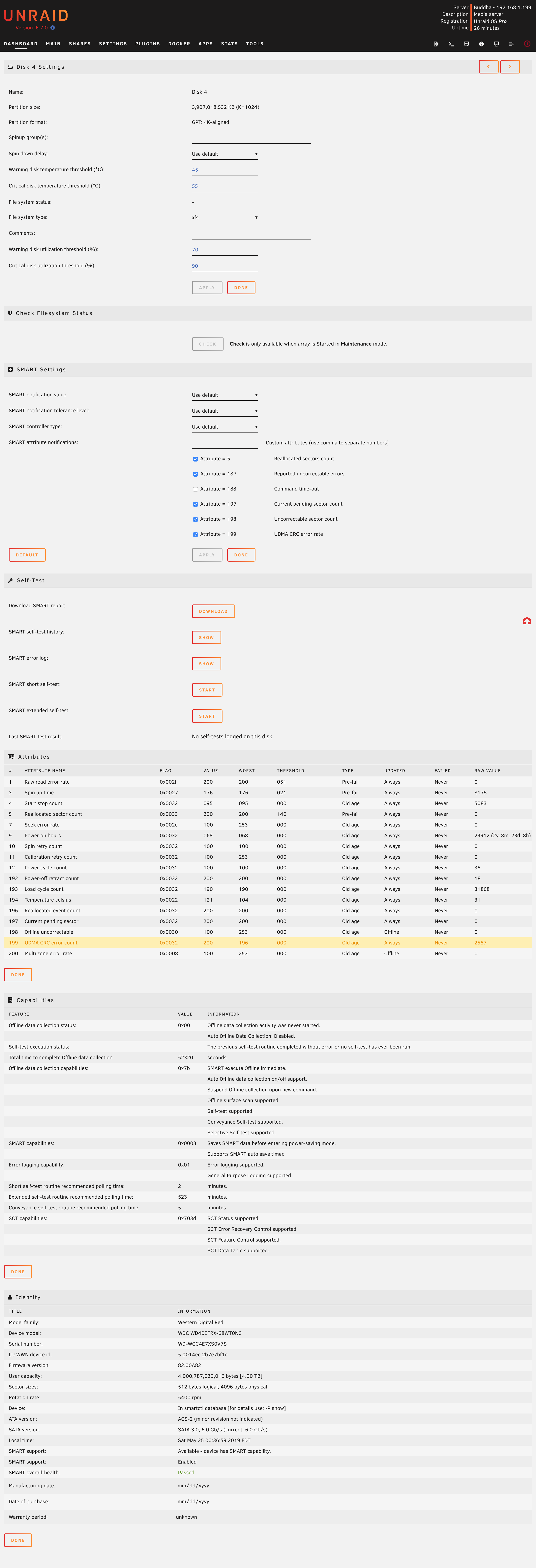

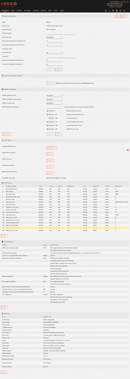

2) SMART Report shows errors with Drives 4 & 5 - UDMA CRC Error reports for both.
3) Read somewhere that you could preclear two drives at one time. Pulled out Drive 4 and replaced with second 8 TB drive. Started pre-clear, got a bunch of UDMA CRC Error reports.

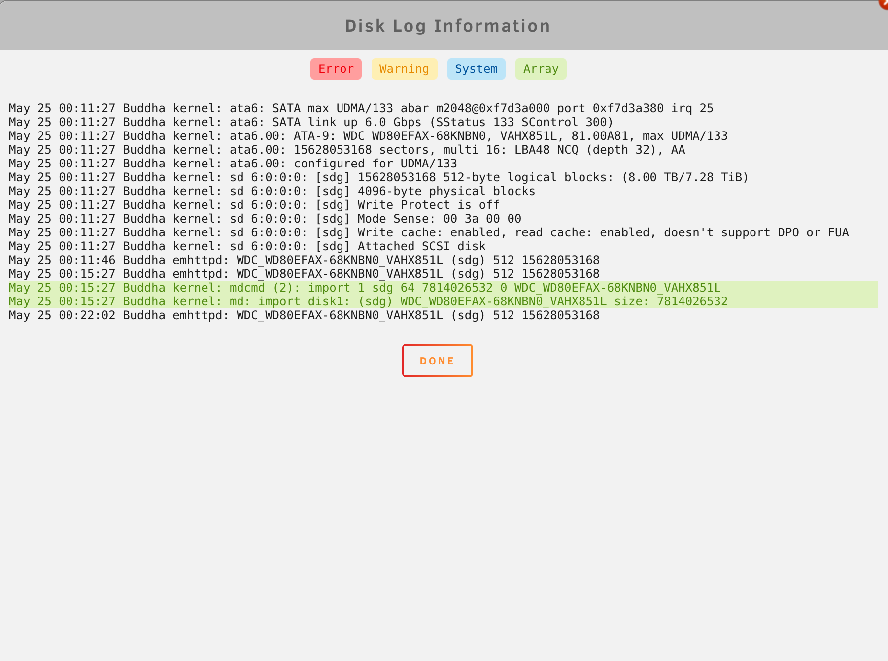

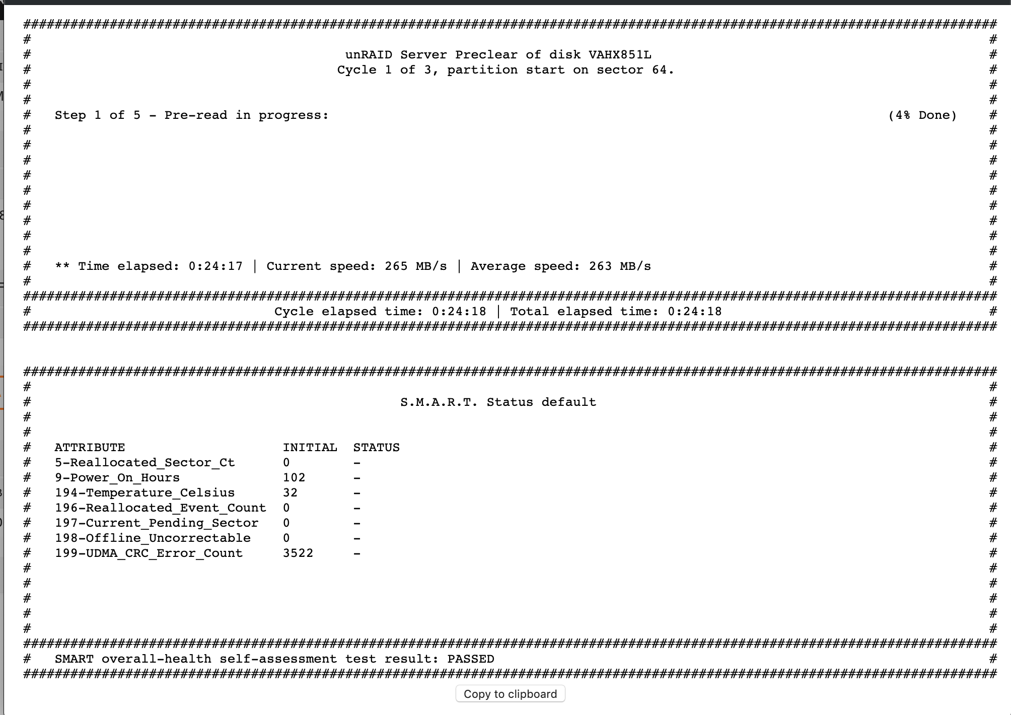

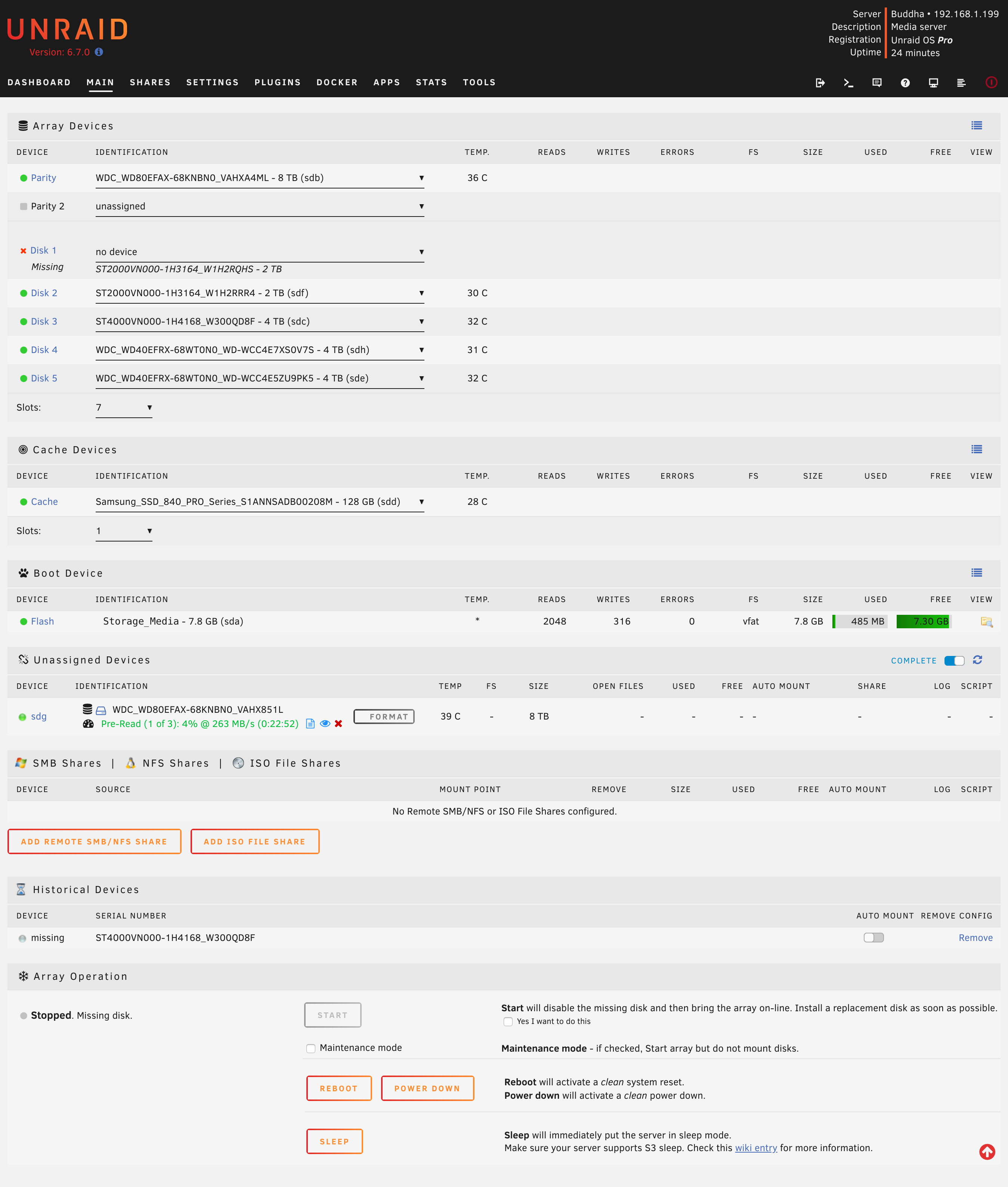

7) Pulled out drive 1 and replaced with second 8 TB WD Red. Started pre-clear operation, told it to abandon the previous pre-clear and start new. Immediately provided a warning about UDMA errors. However, the "main" tab shows it as in the pre-read stage and moving along (slowly but moving along nonetheless). The text in the unassigned devices area is green.
The preclear on the first 8 TB took about 6 days, so wanting to head this off at the start rather than wait another week to find out i've screwed something up.
So bottom line - do I continue to let the pre-clear on the second 8 TB drive run or is it obviously bunk? I'm wondering if it's not suggesting there are errors because I already tried to preclear it when another preclear was going on? Moreover, because the original drives 4 & 5 were newer than Drives 1,2,3 and because drives 4&5 passed the preclear (albeit a few years back), AND b/c I *think* the UDMA errors relate to communication - how do I confirm that the problem is with the drives and not with the OS or the cables? Other potentially relevant information: I have had some issues with disk permissions and such in the past - whereby plugins wouldn't update and couldn't be deleted and my deluge docker suddenly stopped working. When I updated to 6.7, the plugin updating issue resolved itself. I have not started the array since then to be able to learn more about my docker issue. Attached are what I hope are all the relevant screenshots.

CRC errors are a communication issue. most times a bad SATA cable, much less likely it can also be the enclosure or controller.
gotcha... so just buy some new cables and go from there. Thanks!
