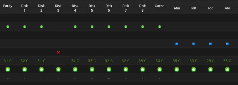

Hey, so I know this may seem odd, but I had a power outage this morning and it caused read errors on a bunch of my drives. See, I do have a battery backup unit but it's not a particularly nice one. Anyways, I rebooted the server and all errors magically washed away only for some reason one of my drives has an X by it and it won't let me do anything with it, there was even notification about how drives no longer have errors. How do I ignore this red X and let the drive come back? I know 100% without any reservations that the hardware is fine and the data is prolly perfect still too as the server wasn't doing anything really when the power went out. The drive that is being emulated was one of the drives that had almost literally nothing on it save from a few random files here and there. I just want unraid to stop emulating the drive, that's it.
ARGH! seems like one of the drives is clunking.... and another had filesystem errors and had to run XFS_reapair the data on it was saved but now unRADI cant use it as a drive for rebuilding or emulating the dead one. Ugh....

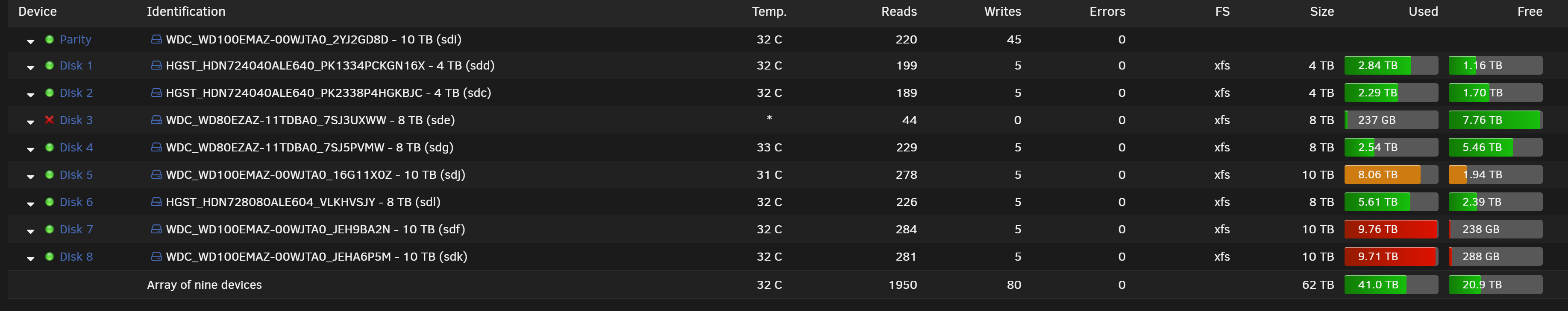

Currently copying data from the dead/dying drive now via the command line onto other array drives. assuming I don't have any other failures, I should be able to save the lion share of the data. I just need to get a few more drives so that I can have a staging area to copy stuff off of the current drives and run a preclear to confirm that they are physically intact. It may also be time to drop in a second parity drive too. 😒
Just went out and bought 3 new 10TB drives. The one that's totally dead is an 8TB so a small upgrade. The repaired one may or may not be good and it is also an 8TB drive. If the xfs_repair drive is actually physically good and passes preclear, I will then look at replacing one or two of my older 4TB drives. I also really want to stick with having two parity drives now to keep this from happening again. Looks like my next week will be taken up by and full of preclearing drives and copying data over to a new array since this one is basically gone and I want to confirm which if any of my drives died. Though I am always open to recommendations if anyone has any.

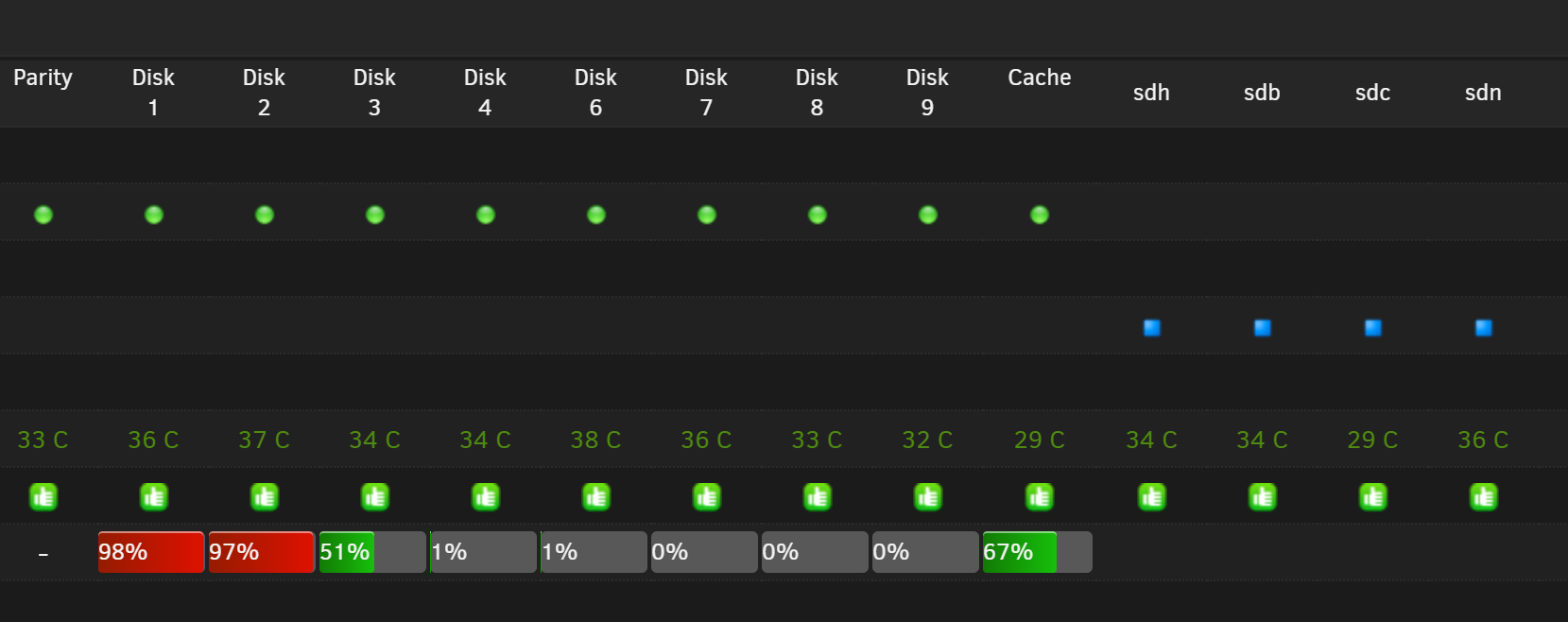

The epic of my server seems to finally be over... The last drive of all of them finally finished preclearing this afternoon. I added to the array and added one to the second parity slot just a few minutes ago the last drive. So far, every bit of data is there and accounted for. The array is now 82TB but now also has that second parity disk, which is building right now in the background. When I sparked plex back up after switching back to my pfSense VM for internet and everything just hummed back to life like nothing was wrong, it made me so happy. It's like my server was just turned off and let sit there for a few weeks for no reason and nothing running on there is the wiser that it was a bumpy ride.
