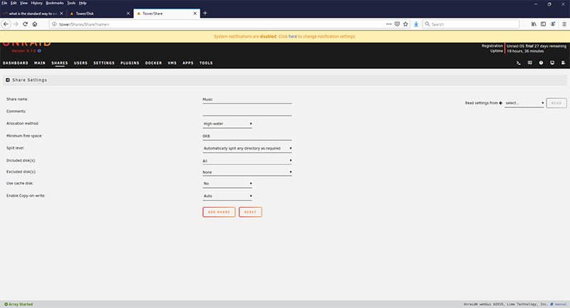

Okay, so I then stopped my array and restarted and appdata/systemdata/domains/Ios returned but no sign of my new Music share. I tried again, same results but again no errors, this is screenshot of what I added

If you post your system diagnostics zip file (obtained via Tools->Diagnostics) then you might get more informed feedback.    Without those you will only get guesses.

Go to Settings - Global Share Settings and make sure User shares are enabled and Disk shares are auto.
After that, go to Shares and post a screenshot.
They were enabled (seems to be the default).
Anyway I have got it working in a roundabout way. I mounted my disk share to Windows, create a folder on Windows, then the folder shows as a user share in unRAID, I can then drop disk share and make user share available to Windows. Put in down to user error, but are there any easy tutorials on achieving these simple tasks that I expect many users want to do. I can see unRAID is very powerful but its a bit daunting to start with, there no real guidance on what do within the application itself.

I would try toggling the option to use User Shares under Settings->Global Share stings off and then on to ensure it is enabled correctly.

The user shares are simply the top level folders on array and cache. If you create a user share, unraid will create top level folders on array and cache as needed according to the settings you make for the user share.
If you create a top level folder on array or cache disk, then it is automatically a user share with default settings. This is the "workaround" you used, but it isn't necessary or the usual way to get this done.
I don't know what may have gone wrong with your attempt to do it the usual way.
