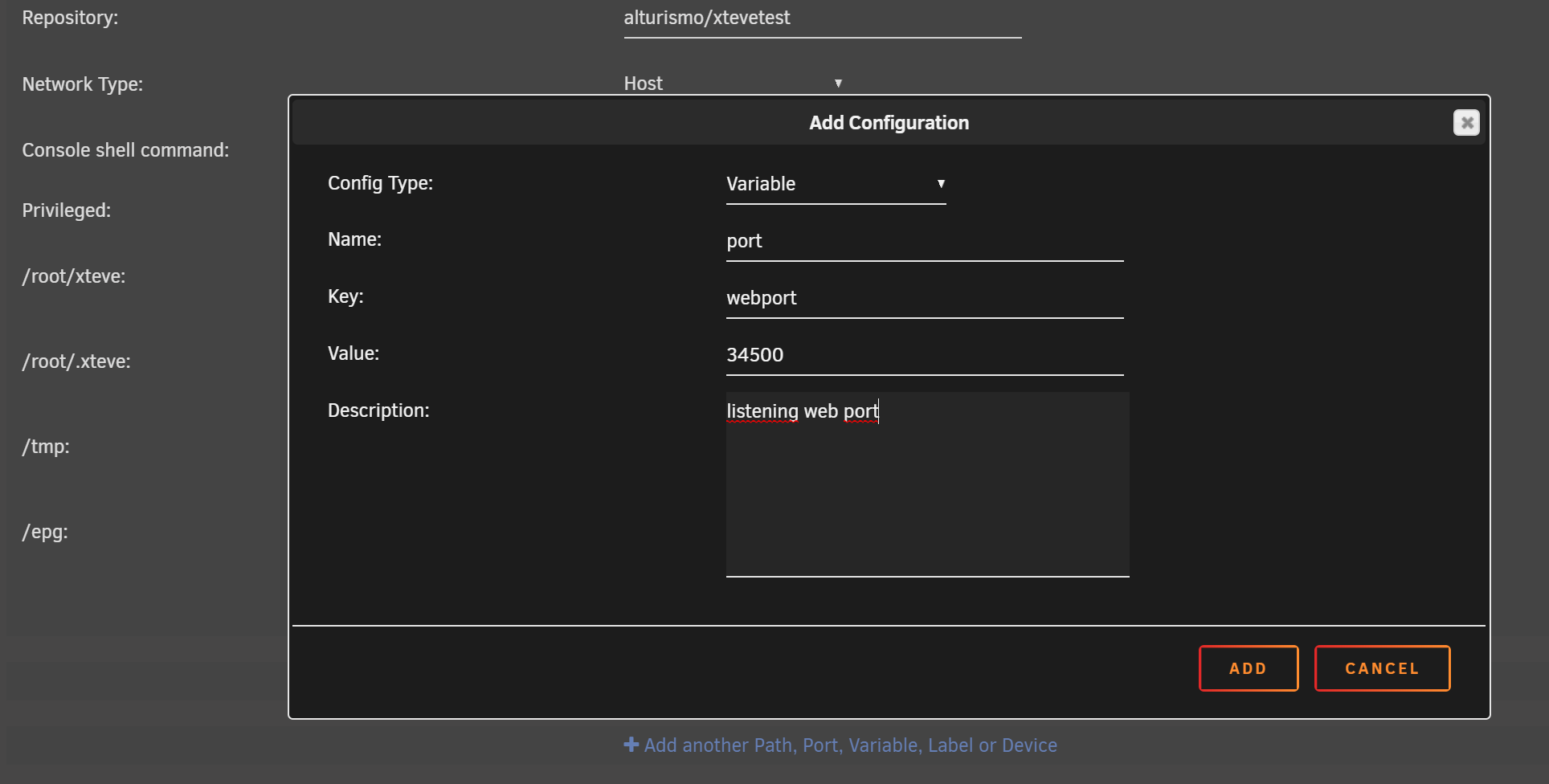

sure pretty simple, i try learning a little about building docker
sample
https://github.com/alturismo/xTeveTest/blob/master/Dockerfile <- working nuttom command port 34400
as you see i run the app and the port in docker hardcoded, now i d like to make the port configurable through the webgui,
so my start was to make it variable
so i could set something in unraid gui ...
sample
as mentioned, 1st docker, 1st tests ... i tried some stiff with ENV and ARG but never came to an result ;)
OK, you're getting confused between what you do in docker versus what you do in the Unraid webgui.
You add a port not a variable when you want to add a port to a Unraid template.  Set the container port to whatever the container port is, then change the host port to whatever you want it to be.
